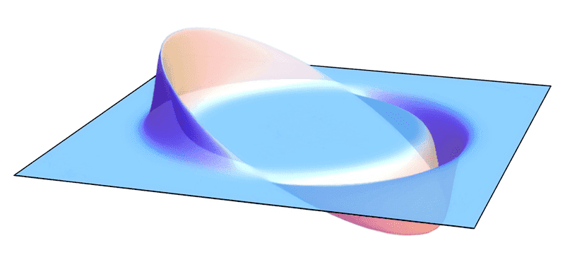

I understand that they are designed so that they can shorten distances in space in front of them, and expand space behind them. It is kind of like a wave that you ride through space. Basically like this:
The picture does not actually mean anything by itself - notice how the distance (measured along the surface) in front of the ship in the picture would actually be longer than if the big hump weren't there - for example?
In simplified-for-SF terms - the drive generates a special distribution of imaginary mass-energy which radically changes the curvature of space-time nearby. The result encloses the ship in a bubble whose time evolution, from outside, zips away FTL. Observers outside and inside the ship would probably still disagree about how much time the journey took - the special feature is that both will agree it was FTL.
Generally, energy will curve space-time according to the Einstein relations.
However, the relations can be worked backwards: so you can input the curvature you want and get the energy distribution out. This does not always produce a meaningful result ... imaginary mass is usually taken to mean that the space-time topography is not possible.
So a drive working on these principles uses "exotic matter" and "negative energy" in very large quantities ... presumably it generates it's own through <insert technobabble here> or maybe the ship-builders have discovered 20 planetary masses of the stuff someplace as a "lucky find". In which case they are overdue some bad luck aye?
