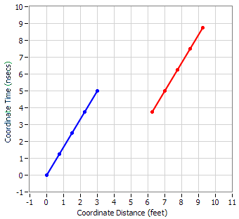

So let's say we have a rod of length 5 feet laying motionless along the x-axis. A spacetime diagram showing this simple scenario is:
The blue and red lines represent the two ends of the rod. The rod is spread out all along the space between it's two endpoints but we don't care about that, we only care about the endpoints that are used in determining its length. I'm only showing the positions of the endpoints for just a short time but we understand that the lines really extend upward and downward. Now let's see what happens if we transform the coordindates of this scenario into one that is moving at 0.6 toward the left. In this new diagram, the rod will be moving to the right at 0.6c and we can see how long it is.
The first thing we have to do when using the Lorentz Transformation is calculate the value of gamma, the Lorentz factor (the same value used to determine Time Dilation), as a function of β, in this case -0.6:
γ = 1/√(1-β2) = 1/√(1-(-0.6)2) = 1/√(1-0.36) = 1/√(0.64) = 1/0.8 = 1.25
Now we take the value of the t and x coordinates of each event (dot) in the diagram and calculate new values for the new diagram. The two equations for the new primed values are:
t' = γ(t-βx)
x' = γ(x-βt)
We can take another shortcut and just calculate the two endpoints of each of the two worldlines and fill in the extra events (dots) proportionally. So for the top of the blue line, x=0 and t=4:
t' = 1.25(4-(-0.6)*0) = 1.25(4) = 5
x' = 1.25(0-(-0.6)*4) = 1.25(2.4) = 3
For the bottom end of the blue line we have x=0 and t=0:
t' = 1.25(0-(-0.6)*0) = 1.25(0) = 0
x' = 1.25(0-(-0.6)*0) = 1.25(0) = 0
For the top of the red line we have x=5 and t=4:
t' = 1.25(4-(-0.6)*5) = 1.25(4+3) = 1.25(7) = 8.75
x' = 1.25(5-(-0.6)*4) = 1.25(5+2.4) = 1.25(7.4) = 9.25
For the bottom of the red line we have x=5 and t=0:
t' = 1.25(0-(-0.6)*5) = 1.25(3) = 3.75
x' = 1.25(5-(-0.6)*0) = 1.25(5) = 6.25
From those calculations and by interpolating (or by more calculations) we can make this diagram:
Now it's important to know that when we want to determine the length of an object (or the space between objects), we have to do it along a line where time is constant. So look at the horizontal grid line where time is 5 nanoseconds. The top of the blue line is on that grid line at x=3 feet and immediately to its right is the second dot up on the red line with an x coordinate value of 7 feet. The difference between these to events (dots) is 4 feet. This is the contracted length of the rod from its Proper Length in its rest frame divided by gamma (5/1.25=4).
You can also see the Time Dilation in this diagram where the dots representing 1 nsec intervals of time in the rest frame of the rod are now stretched out to 1.25 nsec of Coordinate Time.
The other important feature of Special Relativity call Relativity of Simultaneity is also shown where events that were simultaneous in the first frame occur at different times in the transformed frame.

ghwellsjr said:
5) In their explanation for Figure 8 they repeatedly use the words "sees", "see" and "seen" and apply it to a person, which is incorrect. No person anywhere in any scenario can see what is depicted in a spacetime diagram unless light signals are also drawn in. They did not draw them in any of their diagrams. If you do drawn them in, it won't matter which frame you use, they all will show the same thing for what any observer sees.
What the pole or ladder rider sees is what's real. What the cave or barn dweller sees is what's real. If we were to go to the effort of drawing in 45-degree lines from various events to the locations of these observers, we would see that it doesn't matter what frame we do it in. They cannot tell just by observations what the frames depict. That means that they cannot observe length contraction and the only way they can determine the length contraction that a particular frame depicts is if they actually send out and receive radar signals and assume that the signals take the same amount of time going as coming to determine a distance and assign that distance to the average of the sent and received time, then they can make a diagram of their individual rest frame. For an inertial observer like the barn dweller, he will end up with the same diagram as the one I already drew for the rest frame of the barn and he can transform to any other inertial frame. But for the ladder rider, depending on where he is on the ladder, he will get a different diagram than any portion of either of the two diagrams that I drew. This is because he is non-inertial and his rest frame is going to be non-inertial. But he can then use that information and the knowledge that the barn is inertial to construct the same diagram that the barn dweller made and from there he can transform to any other inertial frame. The barn dweller can also derive the non-inertial frame of the ladder rider.
So none of these diagrams depicts anything more real than any other and since length contraction is different in each one, it cannot be said to be real. But all the diagrams depict what is actually real for any observer, namely, what they can actually see and measure.
Likes 1 person
ghwellsjr said:
...But remember, length (or distance) contraction is merely a coordinate effect. When we change reference frames and use the Lorentz Transformation process, the time and length (or distance) coordinates change. Nothing has actually changed to the objects or the space. The same can be said for Time Dilation.
Indeed I like this. Do you agree that “we” does not stand for “the observer” (I mean anybody involved in the experiment and who receives physical signals) but “we physicists who formalize the physical scenario” (I mean a theoretician who is not necessarily involved in the experiment)? Just remember the “moving magnet and conductor” experiment described by Einstein: nowhere he needs to specify where the “observer” stands, it's enough to know that the device which measures the intensity of the current (the physical quantity which gets “observed”) is tied to the conductor.
The former Newtonian mechanics did not enforce such a change in the formal description of the world. It did not impose that physical quantities such as the spatial length and the time duration separating two physical events be assigned different numerical values, via the Lorentz transformation, depending on the IRF selected by the theoretician to represent the coordinates of those events. Hence it did not impose homogeneous descriptions of the world whereby the relevant physical quantities must be defined in respect to the same IRF. For example the thickness of the atmosphere is usually defined in the rest frame of the Earth, whereas the lifetime of a muon is defined in its own rest frame. On that basis the former Newtonian mechanics could not explain that a fast-enough muon can reach the ground before decaying. Only the SR theory, because it imposes to relate the numerical value of physical quantities to the same IRF, whichever one is selected, is able to predict that outcome, irrespective of the selected IRF: a fast-enough muon can reach the ground. Please note that no reference is made to any kind of “observer”.
IMHO the "barn and ladder" scenario should be discussed in the same way: should their respective length be related to the same IRF, whichever is selected, a fast-enough ladder would entirely fit in the barn. Is this correct?
ghwellsjr said:
Observers in a scenario cannot tell that we switched to a different reference frame when we did the above exercise and so nothing changes either in what they see, what they measure, or what they observe. In fact, Length Contraction and Time Dilation are completely unobserverable. They can only be determined by observers by proactively sending out radar signals, waiting for their echoes, observing clocks on other objects, logging all the data and the times they occurred according to their own clock and then doing a lot of computation. Only after the entire scenario is over will they be able to go back and make diagrams like I did and see those coordinate effects.
Do you agree that “we” refers to the theoretician who analyze a unique scenario through different formal representations (different IRFs), whereas “they” stands for the “observer(s)” who is (are) involved in this unique scenario through performing measurements or observations (and who therefore must receive enabling signals)?
Nothing changes in the observable world due to the decision by the theoretician to describe the same scenario alongside a different framework. Changing IRF does not trigger any physical effect, and this is why no change can be “observed”. Your diagrams perfectly illustrate that the propagation of signals toward the “observer” overlays the SR-induced description of the world with 45° lines representing light rays and entails a Doppler effect which affects the outcome of “observations” through a genuine physical (Doppler) effect. Unfortunately most debates about SR fail to clearly distinguish both layers and misuse the words “see”, “observe” or “measure”.

JVNY said:
dEdt and ghwellsjr, thanks. These are certainly very different approaches; it will be interesting to think more about whether they are distinct, or rather different components relativized to a given observer as WannabeNewton suggests.
The two approaches are closely related, and I'll outline how but first I need to make an important point.
Again consider a rod moving in an inertial reference frame. Some people in this thread seem to deny that it is possible to use the laws of physics (as expressed in this reference frame) to deduce that the rod will contract without performing any coordinate transformations. These people are simply wrong. To see why, consider a simpler system: a hydrogen atom in its ground state. If this atom is at rest, it is a simple undergrad-level application of quantum mechanics to calculate the size of the electron orbital. If the atom is moving, while the calculation would become much more involved it is still possible in principle to deduce the new size of its electron orbital. Anyone who argues otherwise is, in effect, arguing that the laws of physics don't apply to objects in motion. And as we all know, we would find that the electron orbital is compressed along the direction of motion compared to the electron orbital at rest. What's true for a hydrogen atom is true for a measuring rod or any other system imaginable.
So, what's the relationship between the physical contraction of a moving rod and coordinate transformations?
While it's possible to calculate the size of a moving rod in the reference frame where it is moving, such an endeavor would obviously be foolish because it would involve probably the most difficult calculation in condensed matter physics ever undertaken. Thankfully there's a simpler way: we exploit the Principle of Relativity.
The Principle of Relativity asserts that there exists a new coordinate system where 1) the rod is at rest, and 2) the laws of physics are the same. This is fantastic because in this new coordinate system we don't need to calculate the length of the rod! We already know it has to be ##L##, the rest length of the rod in the original reference frame, because the laws of physics are the same. So in order to find the length of the rod in the original frame, we just apply a coordinate transformation back to the original coordinate system. And thankfully Einstein already deduced what coordinate transformations preserve the laws of physics: these are just the Lorentz transformations. So by applying a Lorentz transformation back to the original coordinate system, we find that the length of the rod is ##L\sqrt{1-\beta^2}##.
This second approach does not deny that the rod contracts because of the behavior of its intermolecular forces. Rather, it sidesteps having to work out the details of how these forces change when the rod moves by exploiting the fact the laws governing the intermolecular forces (quantum electrodynamics) are invariant under a Lorentz transformation.
Yes, when I said "we", I meant all of us that are defining, describing, analyzing, and discussing a thought experiment. We imagine observers experiencing the thought experiment.
