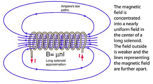

Really, I would have thought it would have been Tesla per meter because how much magnetic field strength over a distance of the superconducting wire, however if it just is Tesla that makes sense too because it's just a flat magnetic field strength for the entire wire which all sections would be the same. So, what would happen if you made Coils/Solenoid of the superconducting wire with N turns, where N was high along with I, wouldn't that increase B above the critical field? I guess you said it had never been done to where it was high enough to destroy superconductivity in a sample? The reason why I wonder this is because doesn't superconducting materials below Tc have a zero electrical resistance so you can run any value of I through it? I guess I'll read this until you answer this thread, link = https://link.springer.com/chapter/10.1007/978-1-4899-6612-4_7

Sure, if you try to use a superconducting solenoid to generate a magnetic field that is higher than the critical field of the superconductor the material will go normal which suddenly means that you have a lot of energy quickly being converted to heat (since the wire is now restive) ; this is known as a "quench".
One of the main challenges when designing superconducting solenoids is that they must be able to cope with a quench without a catastrophic failure (quenches are not uncommon)
If you buy a superconducting solenoid it will have a maximum field rating, exceeding this (by further increasing the current ) will inevitable cause it to quench.
Also, whereas it is true that superconductors have zero DC resistance, there is also a maximum amount of current you can pass before it goes normal, exceeding this current density (in A/m2) will cause it to go normal. Hence, superconductors are limited both in terms of the maximum current and maximum field (the two are -not surprisingly- related)
