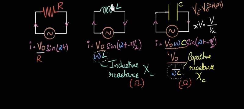

What type of functions are these?
badr
33
Homework Statement: Trying to understand electrical calculations in AC
Relevant Equations: I = V/R
Here it is :
Please be more specific about what you cannot understand so that we can explain it.
I want to know what is the composition of these functions , so that I can study them one by one , and do some exercises .
Are you familiar with Ohm's Law? Are you familiar with complex impedances?
"These functions" are sines and cosines. Have you studied them?
I have not yet studied them , they were part of my apprenticeship years ago but just few examples nothing deep .
I was taking courses in electronics.
I am trying to do a revision while i still have free time.
You might wish to start with the overview shown in this video and follow up with more in the series. The guy in this video seems to talk a lot but he might be what you need because he explains things slowly.
