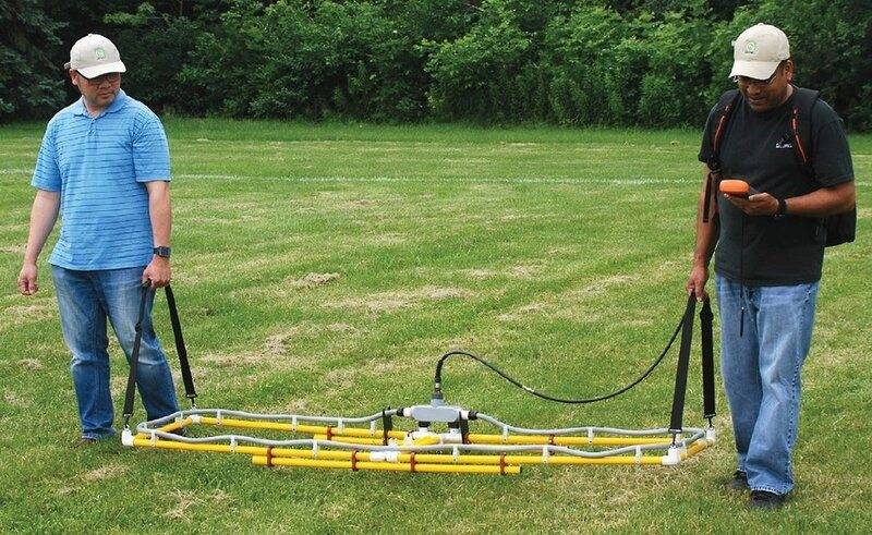

With all due respect metal detectors have advanced by leaps and bounds since 1975 with every few years some amazing breakthroughs have happened.
We agree the assumptions must be changed. That is why I joined this forum. Fresh ideas from young minds open to new ideas, untested methods, and applying existing knowledge in new ways. I don't think breakthroughs will be in an existing metal detecting company... they make small improvements to their products but seldom are the source of true game changing technology.
Before GPR no one thought there was any possible way to "look" under the ground. Now it is in regular use in the geophysics field.
Large detectors like the EM61 LX2 are capable of reaching over 30 inches in depth (unheard of just a few years ago)!
I am not looking for professors who say "if the problem was solvable, I should have done it by now". I want the fresh minds who say "lets figure it out"!
You are exagerating. We had PI back in the mid-70s for looking through salt pans. It just took a long time to reach the lower cost metal detector market. The advances in low cost metal detectors have been in very small steps, not leaps and bounds.
Pulse induction can be used to detect copper ore bodies 3000 feet below the surface. Variations in the Earth's magnetic field are used as the signal source. It takes a week to lay out a set of detector coils on the surface. Then you record data for a week. For deep imaging the frequencies analysed are below 1 Hz. The deeper the body, the lower the frequency.
The problem with GPR below VHF is that it interferes with too many radio services and propagates world wide. A license to operate the equipment will be refused unless the source of energy is radiated by natural lightning strikes. I could synthesise fake lightning strikes, but the lightning mapping networks would identify my position in less than an hour. I would be quickly charged by the authorities with transmitting in a non-permitted mode without a license.

This is progress. I agree a larger array or coil will be required. Perhaps a device that is trailer mounted would be more practical or something that say 4 men could position and allow to remain stationary for the required length of time for the depth of the site (some areas I am looking at have as little as 5 feet to bedrock while others are 10-15 feet deep). Then move the array in a grid pattern based on the previous readings (to follow any pay-streak detected).
I was not aware of this fact "GPR below VHF is that it interferes with too many radio services and propagates world wide." This is the type of information I am seeking. As it is pointless to develop a device that would be illegal to operate. So thank you.
So what is the largest current PI system in use? Thank you again for the assistance.

Pulse Induction requires a circular eddy current be induced, that needs to be a significant loop area in the conductive material. Deeper gold nuggets need to be bigger to be detected from the surface. Disseminated gold dust will be invisible. Large PI loops are used to detect the regional volume of saline groundwater in aquifers.
It could be mobile, something like this.
https://www.usgs.gov/media/images/h...-loop-deployed-below-airborne-electromagnetic
https://www.csiro.au/-/media/LWF/Files/Water/FGARA/Fact-sheets/FGARA_factsheet_electromagnetic.pdf
Or it might be a 1 km square coil laid out on the surface as connected segments of multi-conductor cable with multi-pole plugs.

The detection technology must be matched to your mining technology and the regional geology. There is no advantage detecting gold that you cannot reach with your excavation technology.Pulse Induction requires a circular eddy current be induced, that needs to be a significant loop area in the conductive material. Deeper gold nuggets need to be bigger to be detected from the surface. Disseminated gold dust will be invisible. Large PI loops are used to detect the regional volume of saline groundwater in aquifers.
The airborne electromagnetic mapping information was good and shows the possibilities of larger PI arrays. Thanks for sharing this. The gold I seek is normally found within 15 feet of the surface. As you said no point in "detecting gold that you cannot reach". Which is why I set a goal of 15 feet. I can reach 25 feet with my current equipment but costs go up in proportion to depth. I think a large PI loop is a perfect solution to my problem. Possibly a modular unit portable by 4 men that can remain stationary until the depth is reached then moved in a grid to follow the deposit. Thank you for your reply.
