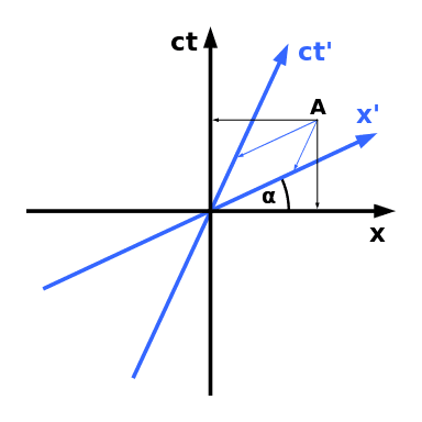

The reason why I ask if the worldline is curved by the frame of reference of the traveler is because it seems like the position of the ball for the traveler has shifted due to length contraction.
I got this diagram from Wikipedia that shows the frame of reference of an object from rest begin moving along the x axis. When we look at the diagram below, we can see that the x' position of event A has shifted towards the traveler, origin 0,0. Now wouldn't the worldline of the ball, that we can call event A, be curved for the traveler's frame of reference. And the worldline should be straight for an observer at rest at the origin 0,0. Aren't there 2 worldlines here?
Yes, position is frame-dependent. Curvature is frame-invariant.
What two worldlines? I only see a single event, A.
So wouldn't the worldline for the ball, located at event A, be curved for the traveler but straight for an observer at the origin at rest with the ball (event A)?
student34 said:
So wouldn't the worldline for the ball, located at event A, be curved for the traveler but straight for an observer at the origin at rest with A?
No, I already answered that multiple times. Asking again will not change the answer. A straight line (geodesic) is a straight line. This is a frame invariant geometric fact.

student34 said:
You seemed to reply with "yes" to my question "Aren't there 2 worldlines here?" in your post #14. I am confused. Are there 2 worldlines for the ball or not?
No, I very specifically and clearly replied that the position is frame dependent. There is one worldline, and it’s position is frame dependent.
Its curvature is frame independent.

Then I just do not understand how the worldline of the ball for the traveler is not curved. In the graph, as something begins to travel fast down x axis, doesn't the x position of the ball, located at event A, shift towards the origin? If so, how can that happen without curving the worldline of the ball for the traveler?
student34 said:
Then I just do not understand how the worldline of the ball for the traveler is not curved. In the graph, …
The graph is not relevant. The curvature is a frame invariant fact of the underlying spacetime geometry. It has nothing to do with any graph. It is a fact about the physical geometry.
The line on the graph is not the worldline, it is a line on a graph. The line on the graph is drawn by plotting the x and t coordinates of the events on the worldline, so its appearance will depend on on how choose the x and t coordinates. But the worldline is the same set of events either way.

Okay but the graph seems to contradict the answer given using accelerometers. I want to understand this from all angles, no pun intended.
The origin and the ball (at event A on the graph) should be parallel worldlines since they are at rest with each other. But it seems unavoidable that the change in the x' position, due to length contraction, of the ball would make the lines nonparallel in the frame of reference of the traveler moving towards the ball.
The graph is not physical. The accelerometers are.
Not sure what you are talking about here. There is no ball in the picture. Event A is not a ball. A ball would be a line in this graph, not a point. A point in this graph is an event, like an explosion.
Anyway, I don’t know how I could possibly be more clear in this thread. The spacetime geometry is an underlying physical fact, like the physical geometry of my table. Do you understand the concept of a physical geometry, independent of any coordinates?
