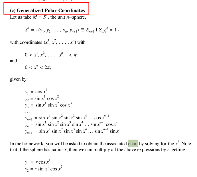

For instance, in Intro to Differential Geometry and General Relativity - S. Waner, page 10, I've found:
PeterDonis said:
Latitude and longitude on a sphere. These are coordinates just on the sphere, and do not either account for or require the sphere to be embedded in a higher dimensional space.
The same is true of every chart used in GR.
See above. I count n+1 dimensions for the ambient space, n dimensions for the sphere.
Hm. Is this the only GR textbook you've looked at? Its approach is completely different from that of any GR textbook I've read. Part of the problem may be that it's written by a mathematician, not a physicist; but it's still surprising to me because a mathematician should understand even better than a physicist the theory of the intrinsic curvature of manifolds, without regard to the usage or even the existence of an embedding in a higher dimensional space.
In short, I do not think this is a good reference.

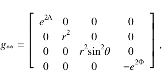

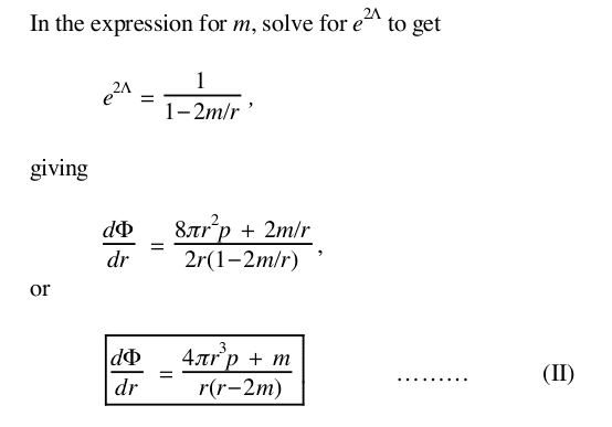

The Schwartschild solution in the textbook I've just mentioned is built to find g** of the form:
(So I was right, the SET is also function of g**).
After setting some more constraints, T** becomes:
Then, after imposing that the equations of motions:
are satisfied, we have the additional constraint:
Then it goes on to solve the differential equations for the single components, finding:
Just looking at this, you'd think that the r in the equations is the actual radius of the star measured in our continuum, while it's a linear (local) coordinate, and that enough is a source of confusion to me.
Also the variable t is a linear/local coordinate, which doesn't match the actual time measured by an external observer. You compute the latter through the metric.

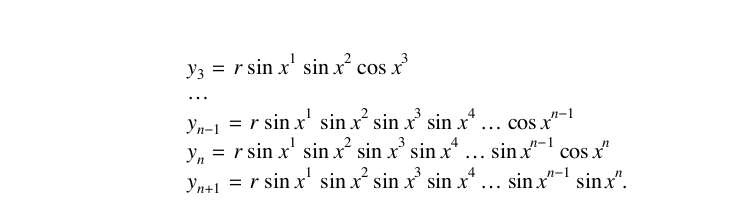

Besides, I really don't know how I could infer the general case from that special case.
Intuitively I thought that the very concept of "curvature" implied the embedding on a higher space.
If you only have a 1D space, you wouldn't have "curved" or "straight" lines, you'd only have "lines", because the curvature only appears in a 2D space or higher. Same thing for the 2D, and higher dimensions, surfaces.
After all, the curvature of a surface is the rate of change of its normal vector, and that is "outside" the surface, in a higher dimension space.
Yes, that's one of the possible ways of writing the metric for a spherically symmetric spacetime. Note that it has two unknown functions in it, ##\Lambda## and ##\Phi##.
No, you wouldn't. Look at the metric. The increment of radial distance is not ##dr##, it's ##e^\Lambda dr##. The coordinate ##r## is, again looking at the metric, the "areal radius", i.e., the area of a 2-sphere with radial coordinate ##r## is ##4 \pi r^2##.
No, it isn't. It's a global coordinate on the spacetime.
Your confusion appears to be the result of an incorrect understanding of what you are reading. See above.
No, it isn't. It's a global coordinate on the spacetime. The chart you are looking at is a global chart, not a local one.
Yes, it does, for the usual meaning of "external observer". The ##t## coordinate matches proper time for an observer at infinity. It does not match proper time for an observer at finite ##r##; the increment of proper time for such an observer is ##e^\Phi dt##, not ##dt##. But such an observer is a "local" observer, not an "external" observer.
You compute the proper time for an observer at finite ##r## using the metric, yes, as I just did above. (Note, though, that that expression is only valid for an observer who "hovers" at the same ##r##, ##\theta##, ##\phi## forever.)
If you look at the Insights articles or the textbook references that have been given, you will see specific solutions being derived using the same general method.
Then you thought wrong. It doesn't. As you have already been told repeatedly in this thread.
That is correct, but it does not generalize the way you claim.
Wrong. For any manifold of 2 or more dimensions, there is a well-defined intrinsic curvature that does not require the usage or even the existence of an embedding in any higher dimensional space.
That is extrinsic curvature, not intrinsic curvature (intrinsic curvature is sometimes also called Gaussian curvature in the literature). The spacetime curvature referred to in GR is intrinsic curvature. If all of your knowledge of curvature up to now has been of extrinsic curvature, no wonder you're having problems. You need to study the definition and examples of intrinsic curvature so that you understand it. It is a different concept from extrinsic curvature.

I don't understand what you mean by "local" or "global" chart. To me a chart is a set of functions mapping the N+1 coordinates of the ambient (embedding) space to the N local coordinates of the N-dimensional manifold.
Here's another example of that type of charts: http://berkeleyscience.com/gr.htm
Why should you use curvilinear coordinates for T** and G** when you have the linear, local coordinates at your disposal?
  • #62
That's not what a "chart" is in any GR textbook I've read, certainly not in any of the references you've been given, or in any of the Insights articles you've been referred to, or in the examples you yourself have been posting. In the example you've given, Schwarzschild coordinates in a spherically symmetric spacetime, the spacetime itself is a 4-dimensional manifold and you have 4 coordinates, ##t##, ##r##, ##\theta##, ##\phi##. Each point in the spacetime is labeled by a 4-tuple of coordinates, with appropriate properties of continuity. There is no "mapping" to any embedding space anywhere.
Since the chart covers the entire spacetime (at least in the example you're discussing--note that this would not be true in the case of a black hole, but you should not even try to understand that case until you understand the simpler case of a spherically symmetric massive body surrounded by vacuum, which is what the example you've been posting is describing), it is global. A "local" chart in GR is something like the Riemann normal coordinates I described earlier; the coordinates are "local" because the expression for the metric in these coordinates is exactly valid only at the single chosen point on which the coordinates are centered, and becomes more and more inaccurate as you get further away from that point. The expression for the metric in Schwarzschild coordinates, however, is valid everywhere.

@PeterDonis I think I've got the solar system case. The link between the physical observation and the SET is very simple.
What about a more complex case, where you have multiple comparable masses in the same region? What kind of constraints should the physical observations put on the EFE?
Nugatory said:
That "rate of change of the normal vector" applies to extrinsic curvature and is completely irrelevant to general relativity
Somebody should tell it to this author:
The Rhijk are the components of the Riemann curvature tensor. Note that the Riemann curvature tensor is defined in terms of the Christoffel symbols, which are functions of the metric coefficients. The Lij and Lij are functions of how the normal vector U changes, i.e., the curvature of the surface. Gauss defined the curvature of a 2-d surface geometrically, and showed that it equals det([L])/det([g]). The Riemann curvature tensor allows the curvature to be computed from values that can be calculated in the surface, the gij. It provides the building blocks for the left side of Einstein's field equations.

  • #76
No, somebody should, as I've already said, stop trying to learn physics from mathematicians. Physicists won't bother trying to tell the author this because none of them are going to read his book anyway. And mathematicians won't bother because they're not physicists and don't see the disconnect in the two bodies of literature.
That said, there is a key point that your reference fails to mention. It has chosen a particular embedding for the examples it gives of manifolds that makes the extrinsic curvature (the "rate of change of the normal vector") numerically equal to the intrinsic curvature (the Riemann tensor). But that does not make the two concepts identical, nor does it mean they will always be numerically equal for any embedding.
I strongly suggest that you take the time to read some references by physicists about GR, such as the ones we have already pointed out.

In Waner's op.cit., pag. 121, we can see that the observable quantity "total mass" helps solve for ##\Phi##:
No, it doesn't. The form of the solution comes from the drastic reduction in the number of independent equations due to symmetry. In the Schwarzschild case, this is what results in one of the EFE components becoming the separable first order equation with solution as described. The total mass ##M## is an undetermined constant in that solution, and it's known to be constant outside the star because outside the star is vacuum, not because knowing its actual value helps us in any way in solving the equations. (There is a boundary condition for ##\Phi##, that it should vanish as ##r \to \infty##, but this is true regardless of the actual value of the total mass ##M##, so knowing the total mass is irrelevant to applying it.)
