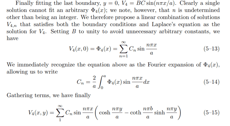

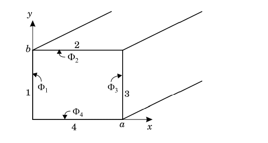

I'm self-studying Vanderlinde and having a great time. However, I think that I am conflating and confusing many different things. Let me just ask them here:
Chapter 5 Laplace's equations.
  1. When solving the equation, ending in a series expansion, in what domain is the expansion valid?
    The potential is specified for side 4, while the other sides are set to zero. From what I know of, the potential is a harmonic function i.e. it takes on a maximum or a minimum at the boundaries. Does this mean that the solution I have found is only valid within the boundary? I think so.
    But then, you can specify two disconnected, nested boundaries like the circle as the lower bound to the radial distance, and infinity.
    So, the author arrives at the equation
    So, where is equation 5-15 valid? It can be used for both the region within and the region outside of the parallelepiped right, as long as the boundary conditions are specified (and delineates the bounding region)?

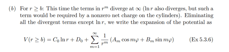

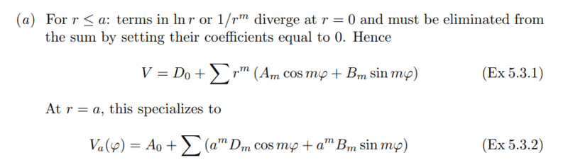

  3. In Example 5.3 on page 100, the author gives coaxial nonconducting cylinders with surface charge densities giving rise to potential, and solves the Laplace's equation by specializing V with r = a.
    But doesn't this mean that ##\nabla^2 V \neq 0 ## anymore, at least on the boundary? So... why are we not solving Poisson's equation instead, with a dirac delta function for the charge density, of course? :smile:
  4. Why is ##\ln r## needed to to have a nonzero net charge?
I think this depends on what one means by valid. May this expression be numerically evaluated outside the region for which it was initially derived versus does it still represent the actual field outside the region. If the series converges outside the region then the answer is maybe but usually not. For example a closed metal box the fields outside and inside are generally unrelated.
