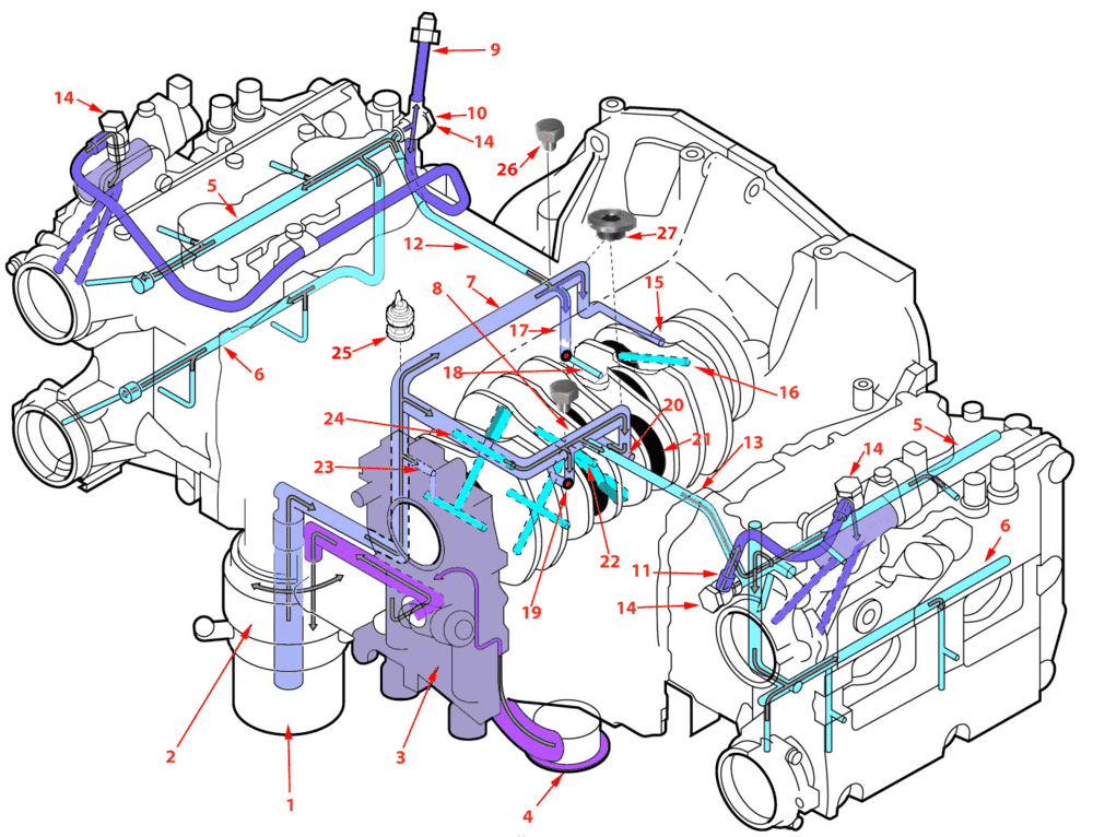

Here is a link to a post and illustration of the oiling system.
During racing I have seen a 10 to 15 PSI pressure drop from the pump's output to the point that the remaining oil is feeding only the cams and turbo. The consumption of the main and rod bearings have lowered the pressure by that much. The oil accumulator is designed such that oil can flow out of it when the pressure is below the desired setting. 10 to 15 pounds is recommended.
Here is where I get into the weeds. A lot of torque, low RPM's and/or low oil pressure is a recipe for disaster in any engine. Oil protection can vary by viscosity, oil properties, heat, bearing clearances and resistance to friction of the mechanical components. Perhaps, for the sake of no arguing about brands, we leave the lubricants out of this? Let's just assume a "normal" operating situation where we are not overheated and we are using a good racing oil.
So, there is a magic number, at below which the pressure will not support a protective film of lubricant. There is also the possibility that the pump has started sucking air and you have aerated oil.
Regardless, the pressure has dropped to the 10-15 PSI threshold of the oil accumulator and it starts to release the oil. Where would you like for it to go? If it's before the pump wouldn't it need a check valve? It could be after the pump. Might it then fight the pump by providing a pressure resistance? Do you inject the oil before or after the main bearings? If after, (I'm assuming) some will go to the main and rod bearings and some will go to the heads.
In this engine, like most pressure systems, the farther from the pump you go the smaller the passages become to maintain the pressure. Whether it's my choice of bearing clearances (standard for a racing Subaru engine) and/or exceeding the design parameters of the pump and oil galleries, I am seeing a significant drop in oil pressure as it transitions from the crankshaft bearings to the heads, with the current design. The design is such that it's the dynamics of the fluid and pressures (and possible additional variables) that I'm have trouble with. Where and how can I best supplement the oil supply? Other remedies?

Someone said they could not see this when they went to the NASIOC link.
I enhanced an oiling schematic so I could better visualize what's happening. With it and the dimensions it is straightforward to calculate areas in the galleries. But what does it all mean?
I think I mentioned enlarging galleries and smoothing and radiusing bends and passage transitions. I port my oil pumps.
I've talked to expert builders and few will disclose their mods, but from seeing one engine case and reading I know I have done pretty much everything the big boys are doing. I am an artist, ex-machinist and owned a prototyping business. I didn't finish engineering school... I've built and modded a few engines over the course of 56 years.

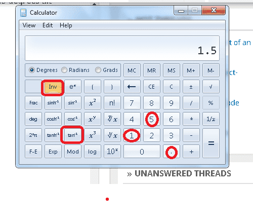

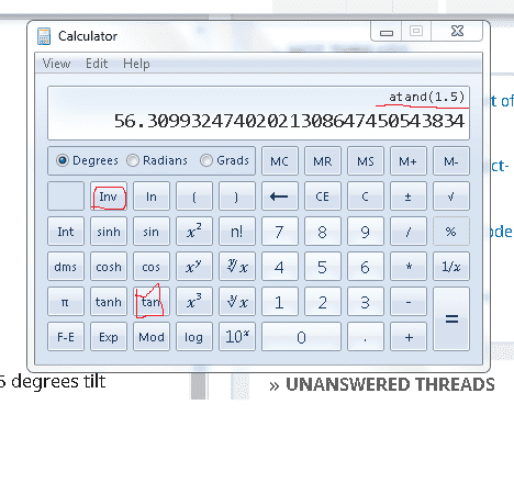

I am very curious as to where the 56° came from! Is there a calculator? With this, it seems I can calculate the vertical distance and see when the pickup would be uncovered. The baffling slows the oil escaping, and there is the issue of how much oil is in the upper areas of the engine.
I once calculated that it would take 11 seconds to pump out what's in the pan, but I did not account for some of it being missing. The highest G turns only last a few seconds. There is the "lightbulb" at New Jersey Motorsports Park where it is well banked for at least 90° of the more than 180° turn. I can generate at least 1.3 G's there @ 90 MPH and it takes about 11 seconds in all to traverse. I've never had an issue there.
In absence of lateral force the surface would be level as shown by yellow line
lateral force pushes oil to one side,
making the top surface of yellow rectangle high on one side and low on the other
exactly as if the car were stationary and being tilted to one side
at 45 degrees tilt
the forces across and up the pan would be equal
tangent of 45 degres is 1.0, which is equal forces across and up(EDIT well down i suppose, gravity pulls down - pardon my crossthreaded words)
to get 1.5X as much force across the pan as force up(oops - down),
which is the situation you describe as 1.5g lateral
the car would require more than 45 degrees tilt
SOOO,
go to windows calculator
atan function gives you the angle whose tangent is what you entered
enter in sequence
circled keys [ 1 ] [ . ] [ 5 ]
then
rectangled keys [inv ] [ tan-1 ]
242930
242928
56.3 deg ?
