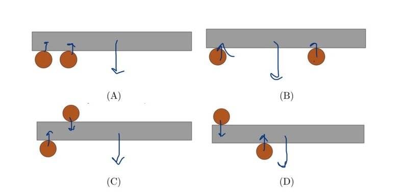

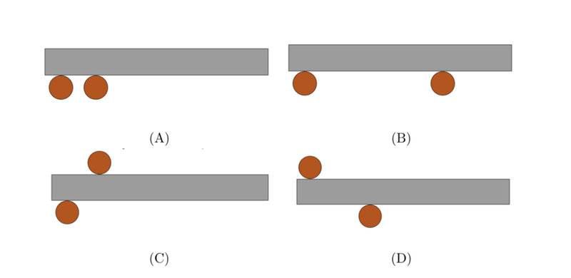

Which of these rods are in equilibrium?
The discussion revolves around determining which rods are in equilibrium based on their configurations. The initial consensus is that rod A is not supported, and participants explore the conditions for rods B, C, and D. Mathematical expressions and torque analysis are emphasized to clarify the balance of forces and torques. It is concluded that while rod D may have the potential for stability, further analysis is needed to confirm its equilibrium conditions. The conversation highlights the importance of correctly identifying pivot points and the relationships between forces and distances for achieving equilibrium.
ymnoklan
71
A rod with a square cross-section is imagined to be supported by two smooth cylinders in four different ways (see figure). Draw all the forces acting on the rod in each case, and use what you know about equilibrium and torque to assess whether it is possible to keep the rod supported in each of these four configurations.
Sigma F = 0, Sigma tau = 0, tau = F*r*sin(theta), G = m*g
(My attempt of drawing the forces is the figure with the arrows). Intuitively I would say that non of the rods are supported in any of these configurations, but I struggle to give a good explanation for why. I could guess that B would be able to keep up, however summing the forces, it seems just as unbalanced as A (which obviously can’t be supported). What have I misunderstood/overlooked?
You are not given the magnitudes, so how can you sum them?
True. How am I supposed to solve this?

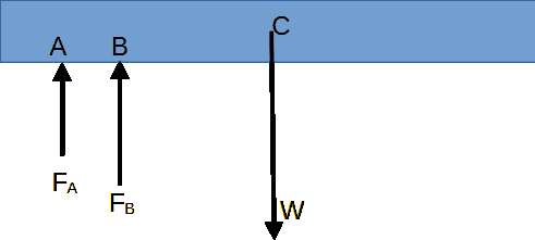

You are saying that (A) is obviously not balanced and I agree. Can you express mathematically why? This should give you a clue about how to deal with the less obvious cases.
In B x>d, which indicates that the rod is supported
Good. What about the other two cases?

I don't think neither C nor D are supported as only the cylinder below the rod can exert an upward normal force. This cannot balance both force and torque.

To guide your thinking (and the math) for (C) and (D) imagine that the top cylinder is a coin, the rod is a ruler and the bottom cylinder is your extended index finger. Your task is to balance the ruler + coin on your finger like a see-saw. Which of the two choices (if any) is more likely to work? Then put in the math to find the conditions for success or failure.

If it is not balanced, there must be a way the rod's mass centre can move downwards without either cylinder moving. In D, if the mass centre moves down then either the left end of the rod must move up or everywhere left of the mass centre must move down.
It is not necessary for the cylinder below to do everything. The cylinder above can help. We only need that the net force from the cylinders is upwards, balancing the weight of the rod, and the net torque from the rods about the mass centre is zero.

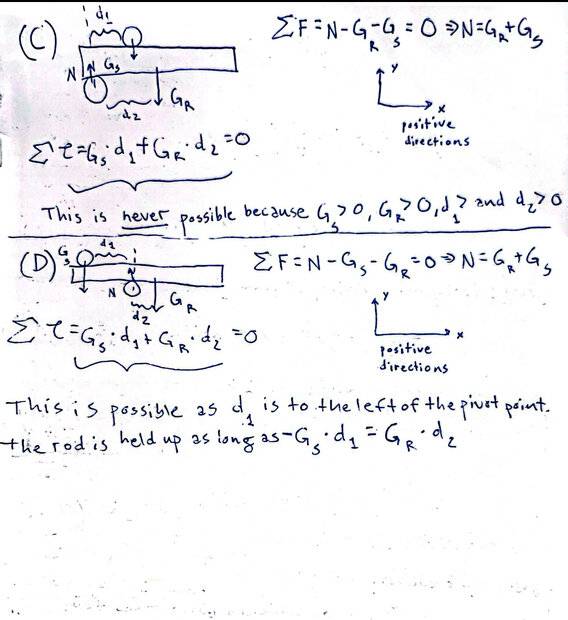

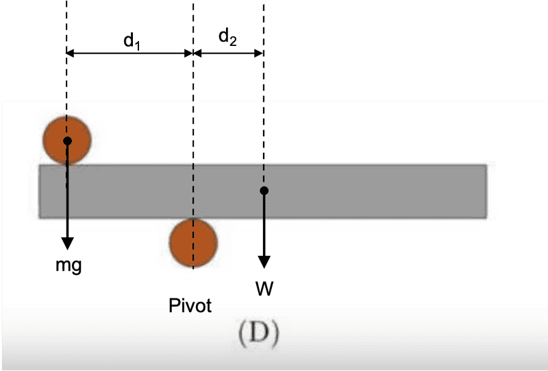

Here is my attempt at the math

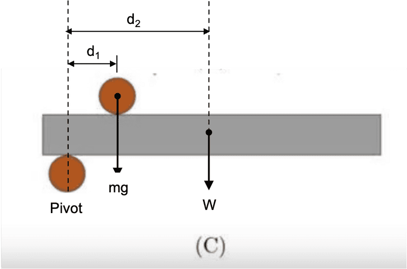

Your answers in (C) and (D) can be made mathematically simpler if you choose a different point about which you calculate torques. Note that if the sum of the torques is zero about one point, it is zero about all points. The rod is not going to suddenly accelerate if you change the reference point for the torques. So you might as well choose a convenient point which is usually the point about which the system will rotate if it is NOT in equilibrium. When the center of mass (CM) is directly above the reference point, the system will be in equilibrium in cases where gravity is the only external force acting.
The CM of the (top cylinder + rod) system is at a point between the midpoint of the rod and the top cylinder. Thus, the picture in (C) cannot work while the picture in (D) can.
In (C) and (D) the convenient reference point for torques, i.e. the pivot, is the cylinder below the rod. You might wish to redo the math with the reference point at the pivot to see how this makes the mathematical explanation easier and to find the equilibrium condition for (D).
Hm, I thought had chosen the bottom cylinder as my pivot point in configuration C already. In D, I did chose the top cylinder as pivot point indeed, but when I try to switch it, the math doesn’t look any simpler. Instead I get a situation where I can’t tell whether d1 or d2 is larger (or equal in size). Well, I guess the equilibrium condition for (D) is d2>d1, or do you mean something else? What have I done wrong?
Maybe simple, qualitative (without any maths) answers would suffice.
For example, for part A), here is a possible answer:
##F_A## and ##W## produce clockwise torques about B. ##F_B## produces zero torque about B. Therefore there will be a net clockwise torque about B. Consequently the bar will rotate about B and fall. I.e. the rod isn't supported.
The distance between cylinder 1 and the center of mass is irrelevant for the purposes of calculating torques. You need to find what mathematical condition must be satisfied for the distance between the CM and the pivot to be zero. The relevant distances are the lever arms, i.e. the distances ##d_1## and ##d_2## from the pivot to the point of application of the force of gravity. See drawings below for (C) and (D). Then setting the net torque equal to zero, should give you an expression that you can solve to find the needed mathematical condition.
Your diagram for D in post #12 has the mass centre between the two rods. This does not match the given diagram in post #1.
View attachment 355592View attachment 355593

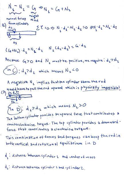

Thank you! Those figures were incredibly helpful. What do you think if this solution then? (I know it is probably possible to simplify the mathematical condition further, however I am not sure how?)
Your algebra is right, and you correctly conclude that D could be stable, but that is not the same as showing it is stable. Can you think of a way to show that?
Do you mean by perturbation analysis?
By whatever means, but perhaps reasoning as in the first half of my post #10.
@ymnoklan equations and text inside images, as in your post #5, are not allowed here. Please post text and equations directly, using the PF LaTeX feature for equations. There is a LaTeX Guide link at the bottom left of the text box you use to post.
I thought showing that the sum of forces and the sum of rotational momentum both equal zero would indicate that the system is stable. Is this wrong? What else is required?
It would, but you only showed the sums could be zero. The sums being zero requires the normal forces to take certain values. Why do they take those values?
Okay, if I solve for N then? This gives me N = (d_2 - d_1)/d_2 which must be greater than zero (because the normal force cannot be negative/downward). This gives the condition d_2>d_1.
No, that still only says there exist values for the normal forces which put the system in equilibrium.
Consider a simpler question. Place a block weight W on the floor. It sits in equilibrium because the normal force from the floor is also W, but upwards. Why is the normal force that value?

The block pressing on the floor deforms it. The floor, being rigid, resists deformation and develops an increasing resistance until it is sufficient to prevent further ingress of the block.
In short, we can define the normal force that rigid bodies exert on each other as the minimum force required to prevent interpenetration.
Applying this to case D, it should be clear that if the mass centre of the rod descends significantly then something has to give: bend, break or be crushed. You could make that rigorous through geometry; no need to analyse forces and torques.
This is is the argument I was hinting at in post #10.

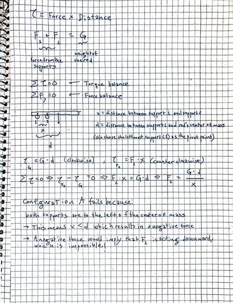

Okay, I think I get it now. Thank you so much for all of your help. I have a similar problem:
A rod with mass MMM is supported by two supports, one at each end of the rod. Each support exerts a force of Mg/2 on the rod, keeping it at rest.
Now, we introduce a third support somewhere between the two others, for example, at a distance a from the left end and b from the right end (see figure). Is it possible to determine the forces exerted on the rod by each of the three supports?
When I try to solve it, I only get these equations:
F_2*a + F_3*(a+b) = M*g*L/2 (torque balance around left support)
F_1 + F_2 + F_3 = M*g (force balance)
But it stops there?
  • #37
https://en.wikipedia.org/wiki/Statically_indeterminate
If you know the shape of the rod when it is relaxed, its dimensions and the characteristics of the material from which it is constructed then you may be able to compute how it will sag over the three supports and, accordingly, how its weight is distributed over them.
There are well known formulas for the stiffness of a beam that may make this fairly straightforward. However, I am untrained in that area of mechanical engineering.
If one idealizes the rod as being straight and perfectly rigid then the situation is statically indeterminate.
But it stops there?
In the idealisation of rigid bodies and straight lines, it's statically indeterminate: https://en.wikipedia.org/wiki/Statically_indeterminate.
To solve it you would need much more detail:
- any extent to which the rod is not exactly straight or the supports are not exactly in line
- Young's modulus of the rod
- hardnesses of the surfaces in contact
  • #39
That was very helpful - thank you!
  • #40
Thank you for your help!
