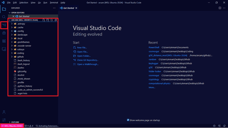

Definitly I am also using VSCode for over a year now and its perfect. It also runs on WSL2 and you can change/edit files from WSL2. Here is one picture
You can edit also those files + use git and do many more...
