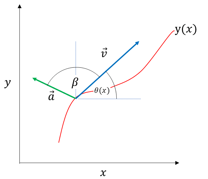

haruspex said:
The problem in post #1 does not appear to be a projectile problem. The ball is moved by some unspecified force.
At an angle to what?
You originally wrote
Now you appear to be limiting the discussion to their vertical components.
Either way, there is no particular relationship between the velocity and the acceleration. An object can be ascending or descending with downward or upward acceleration independently.
Not directly opposite, but you have right idea. Can you put it a little more accurately?
If the direction of travel does not change, what can you say about the direction of the acceleration? Think about a small interval of time, δt, and remember what the definition of acceleration is.
I think I had the wrong assumptions in mind.

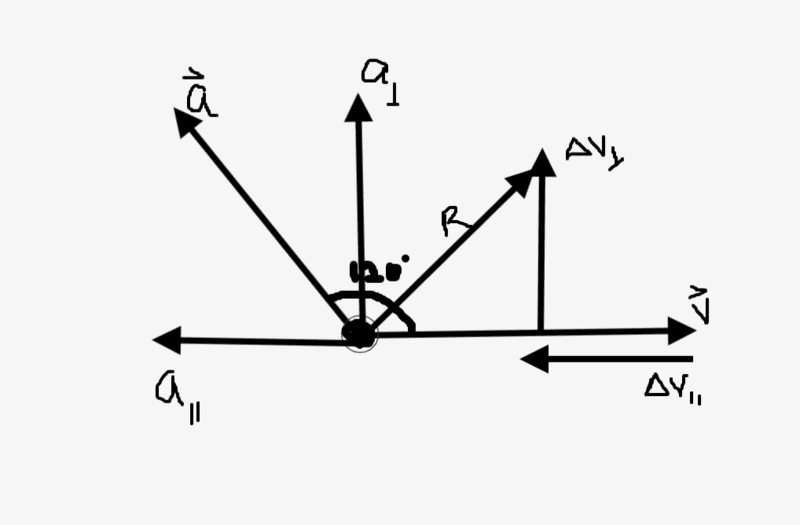

The answer should be very easy if you look at the the parallel and perpendicular components of acceleration vector in the diagram you've drawn. Just apply points 3 and 4 to the parallel and perpendicular components respectively as mentioned in post#11 by @kuruman. Each component will exert it's effect independent of the other. There's no need to do any of the complex thinking like projectiles or centripetal acceleration.
Likes DrClaude and kuruman
Thank you! That makes much more sense.

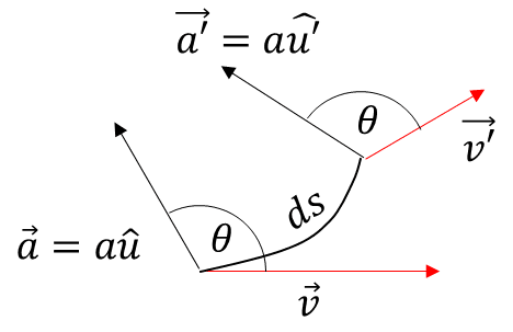

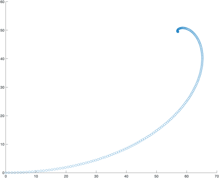

Just out of curiosity, what is the path it is travelling if we assume a constant acceleration magnitude ##a##?
You will also need to assume, say, planar motion.
It might be easier to start at one lower level of time differentiation, i.e. velocity making a constant angle to the position vector.

I was thinking something along the lines of this figure.
Obviously please look beyond the fact that my ##\vec{v'}## is not tangential to the path...it should be. My guess is some kind of a spiral trajectory.

erobz said:
if we assume a constant acceleration magnitude a?
which I took to mean the magnitude was constant. That is confirmed by post #25.
I see it could be read as "assume a constant acceleration, magnitude a", but how can the acceleration be constant, nonzero, if at a constant angle to the velocity?
haruspex said:
My response was to
Indeed, I took the passage to indicate constant acceleration rather than an acceleration of constant magnitude.
Yes, I see how an acceleration of constant magnitude at a constant angle to the velocity still has a "roll" degree of freedom if one does not confine the motion to a plane.

  • #33
I think I have a way (not saying it the best way) to the solution...in theory.
let ##y(x)## be the path the particle is on
##\vec{a}## has constant magnitude ##a##, but is fixed at angle ##\beta## relative to ## \vec{v}##.
The direction of ##\vec{v}## is given by the following relationship
$$ \frac{dy}{dx} = \tan \theta \tag{1}$$
Accelerations:
$$a_x = a \cos ( \theta + \beta) = \frac{dv_x}{dt} \tag{2} $$
$$ a_y = a \sin ( \theta + \beta ) = \frac{dv_y}{dt} \tag{3} $$
Using the Chain Rule and subbing (1):
$$ \frac{dy}{dx} \frac{dx}{dt} = \tan \theta v_x = v_y \tag{4}$$
Sub (4) into (3):
$$ \frac{d}{dt} ( \tan \theta v_x ) = a \sin ( \theta + \beta ) \tag{5}$$
Differentiate the LHS of (5):
$$ v_x \sec^2 \theta \frac{d \theta}{dt} + \frac{dv_x}{dt} \tan \theta = a \sin ( \theta + \beta ) \tag{6}$$
Sub (2) into (6) for ##\frac{dv_x}{dt}## and rearrange:
$$ \frac{d\theta}{dt} = \frac{a}{v_x \sec^2 \theta } (\sin ( \theta + \beta ) - \cos ( \theta + \beta) \tan \theta ) \tag{7}$$
Applying the Chain Rule to (7) to eliminate the parameter ##t##:
$$ \frac{d \theta }{dx} = \frac{d\theta}{dt} v_x = \frac{a}{\sec^2 \theta } (\sin ( \theta + \beta ) - \cos ( \theta + \beta ) \tan \theta ) \tag{8}$$
In theory...solve (8) for ##\theta (x)##, and solve (1) to find ##y(x)##
I'm not brave enough to attempt an analytical approach. Perhaps it's just because trying cartesian coordinates it seems like an analytical pipe dream?
  • #34
I almost gave up too quick... That whole RHS reduces dramatically by applying the sum difference formulas:
$$ \frac{d \theta }{dx} = a \sin \beta \cos \theta $$
I can get a little further:
$$ \ln \left| \frac{ \sec \theta + \tan \theta }{ \sec \theta_o + \tan \theta_o} \right| = a \sin \beta ( x - x_o ) $$
$$ \sec \theta + \tan \theta = \left( \sec \theta_o + \tan \theta_o \right) e^{ a \sin \beta ( x - x_o ) }$$
Then let ##A## = RHS and multiply through by ## \cos \theta##:
$$ 1 + \sin \theta = A \cos \theta \implies 1 + \sqrt{1 - \cos^2 \theta} = A \cos \theta $$
That becomes:
$$ \cos \theta \left( \left( A^2 + 1 \right)\cos \theta - 2 A \right) = 0 $$
It should follow that ( ignoring solution ##\theta = 90^{\circ}##:
$$ \cos \theta = \frac{2A}{A^2 + 1} $$
Then we can say that:
$$ \tan \theta = \frac{ \sqrt{ (A^2 + 1)^2 - 4A^2}}{2A }$$
Now, we are back to where I was before. Theoretically, you could then plug that into (1) and integrate to get ##y(x)##.
$$ y(x) = \int dy = \int \frac{\sqrt{ (A^2 + 1)^2 - 4A^2} }{2A} dx $$
Where A is given by:
$$ A = \left( \sec \theta_o + \tan \theta_o \right) e^{ a \sin \beta ( x - x_o ) } $$
I thought it was kaput, until I noticed the difference of squares under the radical:
$$ \begin{aligned} y(x) &= \int \frac{\sqrt{ ( (A^2 + 1) - 2A )( (A^2 + 1) + 2A) } }{2A} dx \\ \quad \\ &= \int \frac{\sqrt{ (A-1)^2 ( A+1)^2 }}{2A} dx \\ \quad \\ &= \int \frac{A-1}{2A} dx +\int \frac{A+1}{2A} dx \end{aligned}$$
Surely this is a complete blunder...I'm getting that:
$$ \int \frac{A-1}{2A} dx +\int \frac{A+1}{2A} dx = \int dx = x-x_o $$
What...
$$ y(x) = x - x_o$$
??:redface:

  • #44
Lnewqban said:
The reason for the spiral is beyond my limited understanding.
The spiral seems straightforward enough. I assume that we are taking the version of the problem where we have a projectile moving in a plane subject to an acceleration of constant magnitude always angled to the left and back at 120 degrees from the current velocity. An initial guess at the resulting trajectory would be a logarithmic spiral.
Clearly this leads to speed as a linear function of time. The projectile will cease moving at a future moment that can be easily calculated. At this time it will be at the center of the spiral. Velocity will cease to have a direction and the given description of the projectile's motion will cease to be predictive.
We might consider re-casting the problem to consider a projectile moving in the opposite manner -- spiralling outward from the center and using polar coordinates to track its motion.
  • #45
Thank you for that excellent explanation, @jbriggs444
  • #46
I was intrigued so I did a numerical simulation. The initial conditions are ##\vec{v} (0) = 10 \vec{i}##, ##(x,y) = (0,0)##, and the acceleration is taken as ##|\vec{a}| = 1## (all units are arbitrary). The plot shows the ##(x,y)## position at time intervals of 1/10. The simulation ends at ##t=20## when ##\vec{v} (0) =0##.
Likes PeroK, kuruman, jbriggs444 and 1 other person
