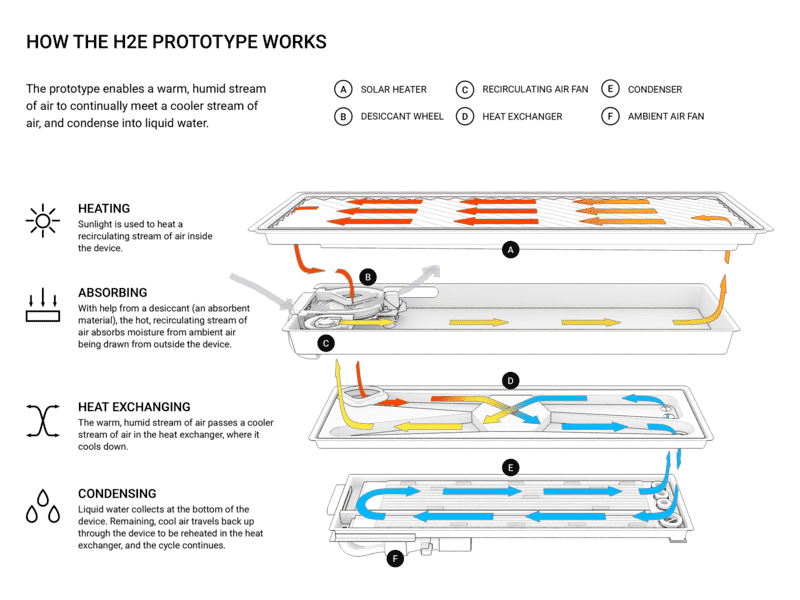

I'm looking to discuss the main variables that define the output/yield of a Atmospheric water generator device.
Good day all:smile:!
I've been researching on 'Atmospheric water harvester' (AWH) devices.
As I researched many functioning mechanisms on such devices, the most workable mechanism to me seems to be the one illustrated in the picture attached to this thread. (i.e running hot humid air over cool air using renewable energy source & collect the condensing water output.)
So my questions are twofold:
1) Am I right in thinking that this mechanism could be the most efficient to harvest water with no outside interference?
2) And what are the main variables that would affect the condensing water output we can get ..
In my mind, I suppose: the more mass volume of both hot & cold air we can get in contact per unit time, the better the condensing output?
Thanks a lot in advance for your input!

Welcome to PF.
You do not show where or how the humid air enters the system.
You do not show where the cool dry air is released.
Heating saturated air will not increase the water mass contained. You must cool moist air below the original cool entry temperature to get condensate out.
Heating air will reduce the Relative Humidity, but I see no liquid water supply available to saturate the heated air.

Thank you for your reply! Let me clarify the system.
The air is first made hot through solar collector on top part of the system.
The fan on the lower side of system sucks in ambient air & produces the cool air.
Both the hot humid air & cool air are made to get into contact, thereby generating the liquid condensate that is collected on the bottom.
Am I right to think that if I manage to create a system that generates more hot humid air from the top part per unit time, & simultaneously generate more cool air per unit time, I can keep increasing the condensate quantity?
If so, what would be the key constraints & other variables that affect the output.
Thanks again for your help. :smile:

What's the source of the diagram ?
[edit: it doesn't show the flow of the ambient air, only "recirculating air" ; can't find it on the web, either]

Hi, thanks for your input.
The device design is from Google (Alphabet) which they open-sourced recently.
For the hot air input, the ambient air is just sucked in from outside the device.
For the cool air input, the ambient air is again sucked in via a fan at the bottom.

Yeah, and thanks loads for making me have to google for the original link.

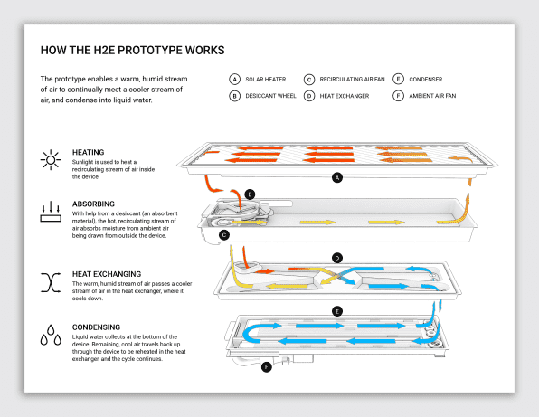

Garbage article from google/x-company ; it does contain a larger resolution diagram of the device where - given an existing (but shallow) knowledge of the existence of desiccation dehumidifiers - it's easier to figure out what's actually happening
A directly related article/paper in Nature which looks possibly interesting and I might read tomorrow if the headache from looking at the crap article subsides.
It's a desiccant dehumidifier : they exist ; I think the "new" thing is the man-portable paradigm.
The inside air and the outside air do not mix.
There's a turntable (close to the B mark on the diagram) which contains a desiccant.
As it turns, outside air is blown across the surface, which sucks out some moisture because that's what desiccants do. (The outside air then leaves the device, never to be seen from, again).
It continues to turn, the slightly soggy surface passing through the curtain to the inside, where hot(ter) internal air is blown across it, evaporating some of the water. The particular patch of turntable we're looking at then returns to the outside as fresh, shiny and dry.
Meanwhile the inside air goes and does the heat exchange thing, which cools it and causes some of the water vapour to condense. It then returns (through the other side of the heat-exchange) to the turntable.
Yes, it works. The article says so, and even says the prototype does "150ml/h/m^2", though it mentions neither what the m^2 refers to (presumably one of either heating or desiccant surfaces), nor the environmental conditions under which the measurement/calculation took place.
Efficient ? compared to what ?
It doesn't look like a prototype so much as a proof of concept. In my pretty much totally uneducated-on-the-subject-matter opinion it could be done without the fans, though : probably less efficient, but niftier IMHO. On the other hand, you could use the (presumed) solar panels which run the thing to charge a cellphone to call for a pizza. That bit's efficient in respect that the waste heat from electricity generation is actually being used (to heat the internal air).
Not to denigrate the people who designed and put it together; I'm not going to pretend I could do it.

I don't see anything wrong with the theory, not qualified to comment on the engineering.
The system transfers water from the atmosphere to a bucket through two sequential fixed media : dessicant and internal air.
Warm air from the outside comes in, interacts with the dessicant and goes out, slightly drier. It has the dual purpose of cooling the dessicant and provides it with some moisture.
In an internal closed loop, very hot air picks up moisture from the dessicant and is moved to a cooler zone where it is cooled and deposits the moisture. It is then heated again, etc.
Note that while it's a continuous process, it might require quite a bit of apparently fruitless circulation before the internal air has picked up enough water to start condensing on the cooler surface.
Likes anikad

I was referring to the original design containing no dessicant.
Here I was in particular commenting on @cmb suggestion that a pressure change would be requiired. There may be other methods as well involving surface reactions using temperature directly.
  • #36
This one ? (larger image from the article)
I added in the purpl'ish arrows in the second-from-top level (missing from the original diagram) to illustrate ambient air movement. The round thing is what I thought was a flow-across turntable, but is apparently (or possibly) a flow-thru (turning) disk.
For the OP's possible edification, the tray with the heat-exchanger on it, the airflows are not actually mixing : inside the hexagonal structure, pipes that carry the airflows carry out the heat exchanging.
Likes anikad

Well, you just can't say this is how it works and I can get water from air.
There is ( probably ) a limited temperature / humidity levels of the outside air, and heating from the sun, where the system will complete it's function as planned.
The air at the cool surface has to be at 100% humidity for condensate to form.
For example,
If the outside air is at 20 C 30% RH your cooling surface will be at 20 degrees also, since you are not actively cooling that surface.
If you can get the cooler air up to 100% humidity then well you will have condensate.
Then ask yourself the question, how much heat needs to be added to the air at the top section so that the RH of the top hot air is less than 30% for the wheel to transfer moisture from the ambient air to the wheel to the hot air. What is that temperature? If the temperature does not reach that level then the wheel ends up working in reverse and transferring humidity from the hot air to the outside air.
Suppose the temperature rises just 1 degree about that needed just below < 30% humidity.
Then the system does do as planned, but the yield amy be a drop an hour <-- just a simple guess.
You will have to look at your psychometric chart to get answers.
You really have to do an engineering analysis, to determine at what temperatures and RH's where the system can do something useful.
Here's a start.
https://www.odellassoc.com/how-do-desiccant-dehumidifiers-work/
https://www.trane.com/content/dam/T...wsletters/airside-design/admapn016en_0905.pdf
Likes anikad
This version can work. Purple arrows.
Likes anikad

Thank you! Now you really appear to be my accomplice:biggrin:.
So the engineering analysis of this system comes down to this : The greater the temperature difference between hot air & cooler ambient air, the quicker the air picks up enough moisture to reach 100% humidity- to be brought to a cooler surface.Am I thinking correctly?
  • #50
