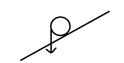

Why do you draw the force of gravity as if it acts on the left edge of the cylinder?
you can have it like that, but don't make the mistake to replace the whole rod with a point body
there is still a couple of forces exerted, which will make the rod to roll, given there is rolling friction, but not air resistance

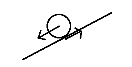

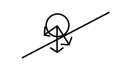

I see a "free body diagram" with a force of gravity correctly positioned to act at the center of gravity of the cylinder but with two additional force vectors at right angles. What are those? And where is the normal force from the slope on the cylinder?
I see a free body diagram with a force acting parallel to the downward slope acting on the center of the cylinder and a force in the opposite direction acting at the point of contact. What force is represented by the down-slope arrow? What force is represented by the up-slope arrow?
you see the analysis of the force of gravity
and in the second, you see the moving part of the weight force analysis, and its couple force at the point of friction
Note that the force of gravity produces zero torque about the center of cylinder. The only force that produces a non-zero torque is the force of friction at the point of contact.
Note that there is no guarantee that the force of friction is equal in magnitude to the resultant of gravity plus the normal force. To my mind, that means that referring to the two as a "couple" is not accurate.
