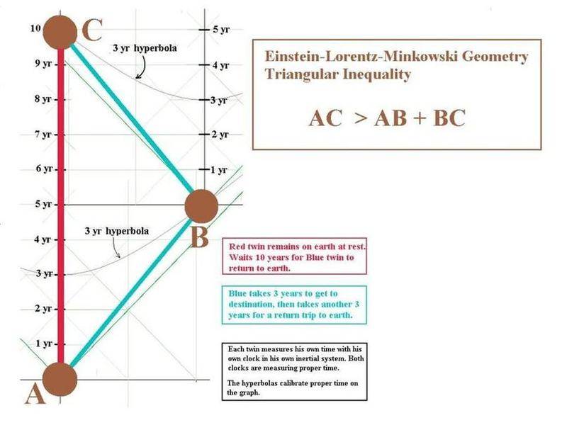

  • #39
GrayGhost said:
Easy this to say. Hard to prove. If you think about it long enough, my bet is that you change your opinion on that matter. The only proof we need in support of said contention is a standard Minkowski diagram, and the assumption that what is predicted by the LTs "is real". It's not in conflict with the LTs in any way. It merely addresses the nature of time, and hence a deeper implication of the nature of spacetime.
Good post, GrayGhost. Let me take a shot at sketching the Minkowski diagram. I'll use the setup with a blue guy moving to the right at relativistic speed with respect to a black rest system. A red guy is moving to the left in that same system with the same speed (blue and red guys moving in opposite directions with same relativistic speed). In the upper left sketch I have marked off equal distance positions along the respective world lines for the blue guy and the red guy. The fact that we use this symmetric spacetime diagram assures that the calibrations of distances for the blue and red coordinates are the same (otherwise it would be necesary to use the hyperbolic calibration curves).
The blue and red guys each reach the position number 9 at proper times that match each other. The rockets and all objects inside the rockets, including clocks and human bodies, are 4-dimensional objects, so it can be perplexing trying to comprehend who or what is doing the moving. The usual language is that each observer moves along his own world line at the speed of light, c. Einstein's colleague, Hermann Weyl, said something like, "...the observer crawls along his own world line." So, some distance traveled along the 4th dimension would be dX4 = c(dt). To avoid a sidebar on that issue, for now, let's just play like there is some aspect of nature associated with consciousness that moves along the 4th dimension at speed c. It is interesting to ponder the enormous length of a life sized 4-D object along its X4 dimension as compared to their almost negligible X1 length.
So far we have a sketch of the R4 manifold (supressing X1 and X2) with the world lines of the 4-D objects. So, we're having really a purely spatial discussion. The X1' coordinate (blue) and the X'' coordinate (red) is oriented such that the photon world line always bisects the angle between X1 and X4, X1' and X4', ...X1'' and X4''. A photon world line would always bisect the angle between any observer's X1 axis and X4 axis. As a result of this circumstance of the 4-dimensional world, every observer will observe a ratio of 1:1 between displacement along the X4 axis and displacement along the X1 axis for any photon world line. In other words, all observers measure the speed of light as c.
Now, having set up the Minkowski spatial picture, we see in the upper right sketch that one can form a right triangle using X4'', X1', and X4'. Given this purely 4-dimensional relationship, it requires only high school math, Pythagorean theorem, to derive the Lorentz transformations. Here, for example, we derive the transformation formula (rotational) for time, t'' (a clock reading in the red rocket), as a function of the blue clock's time, t'. (see lower right sketch)
The formula indicates that the red guy's clock will lag behind the blue guy's clock as observed by the blue guy. The blue guy's instantaneous 3-D cross-section of the universe, blue's "NOW", intersects the red guy's 4-dimensional rocket at red position 8 when the blue guy is at position number 9. This explains quite clearly the reason for the time dilation effect of special relativity.
But, red's "NOW" (when the red guy is at his position number 9) 3-D cross-section intersects blue's 4-dimensional rocket at blue's position number 8, and sees that the blue guy's clock is lagging behind his own.
Likewise, the lower left sketch illustrates the length contraction effect of special relativity.

Mike_Fontenot said:
ALL of the other alternative reference frames for an accelerating traveler (other than mine) contradict the traveler's own elementary measurements
No they don't. You have never demonstrated this and it is false. All frames will agree on the result of any measurement.

GrayGhost said:
The pathlength is the length of the spacetime interval (s), which is nothing more than the proper time experienced by the oberver at both events. Although s is the length of the hypthenuse (slanted worldline of the traveler) on a Minkowski diagram, it is temporally shorter than the stationary observer's vertical time axis (over the same interval).
Phrak said:
You have something inverted. Unlike a straight line in spatial dimensions, the interval of a freely falling object in relativity between two spacetime events is not a minimal but a maximal displacement measured in proper time.
I missed this one before ...
Incorrect. I was talking SR. He who resides at both events always measures the least amount of time for the interval. If 2 observers reside at both events, eg in the twins scenario, then the one who travels the shorter path thru the continuum ages less over the interval, because he accrues less proper time.
GrayGhost

  • #56
GrayGhost said:
You meant the shortest path thru spacetime, yes? The pathlength is the length of the spacetime interval (s), which is nothing more than the proper time experienced by the oberver at both events. Although s is the length of the hypthenuse (slanted worldline of the traveler) on a Minkowski diagram, it is temporally shorter than the stationary observer's vertical time axis (over the same interval).
Defining path length through spacetime as the spacetime interval is one way of doing things and possibly the formal/regular way, but it was not what I meant. Let us say we plot a right angled triangle with vertices A,B and C on a graph with the axes labelled x and y, with the side AC being the hypotenuse. The path from A to C is longer than the the path from A to B or from B to C. It is by this definition that I mean that the longest path through spacetime (with time substituted for the y dimension) is the hypotenuse and it the longest path that experiences the least proper time. Saying the path with the shortest proper time interval is the path that experiences the least proper time is a circular definition. Defining the longest spacetime path length (with time scaled to an equal footing with space) as the path with the least elapsed proper time works in any number of dimensions. For example if we have a clock on the perimeter of a rotating disk then this clock moves in two space dimensions and one time dimension and traces out a spiral path in the inertial frame that remains at rest with the centre of the disk. This spiral path is longer than the vertical path of a clock that remains at rest in the inertial frame and so the clock on the disk experiences less elapsed proper time. In the classic twins experiment, the twin that travels away from Earth and then returns has the longest spacetime path and experiences the least proper time. When the twins experiment is transformed to the point of view of any inertial observer, it always remains true that the twin with least elapsed proper time travels the longest path through spacetime (in SR).
  • #57
youiop, I think GrayGhost may have been picturing 4-dimensional distances differently from what you describe here. Consider the spacetime diagram below for the situation you were describing. When drawing a spacetime diagram for this situation I think it may help to put in the hyperbolic calibration curves that keep track of the proper distances for the two observers. The "line lengths" that you would measure putting your ruler on the computer screen do not correspond to the actual proper distances; you must use the calibration curves. Proper distance is of course just the speed of light times the proper time.
The sketch of the popular twin paradox is intended to convey exactly what GrayGhost put into words. The thin green lines at 45 degree angles represent photon world lines (they of course travel at speed c). (Sorry if I've misread your meaning)
  • #58
This seems confusing. You are using two different metrics, with different signatures, with the same coordinates and making comparisons between them. Why not 3 different metrics with 3 different signatures?
I also think the statement is false anyway. Consider the path (using (t,x)) from (0,0) to (2,.1) to (0,1). This is 'longer' than from (0,0) to (0,1) using your alternate metric, and *also* longer using the Minkowski metric.

  • #64
PAllen said:
I was talking geometry, not particle paths. Also getting at the feature that with Euclidean metric you can make strong global statements about extremal properties of geodesics. With SR or GR you cannot. Extremal properties need qualification and with GR are only local at best. Note, geometrically, is there anything wrong with going forward and backward in 'x' along a path? If you are choosing to introduce a Euclidean metric, why should going forward and backward in 't' be any different?
When one discusses Euclidean space, one uses one metric, and pure and simple. You seemed to say using one metric in SR leads to circular definitions. I find this a strange statement which I disagree with.
I agree if we allow particles to exceed the speed of light or travel backwards in time, then yes you can construct "longer paths" through space-time with greater elapsed proper times, but if we restrict ourselves to measurements or real particles then this problem does not occur. Perhaps another of expressing what I was getting at, is that if (and only if) we have two clocks that are initially and finally co-located, then the the clock that has traveled the furthest distance through coordinate space will have accumulated the least elapsed proper time.
In the context of the twins paradox we might explain it like this. Calculate the proper time that elapses for each segment of the each twins journey. Add up the elapsed proper times of the segments. The twin that has the least total of proper times, will as a general rule, be the twin that has experienced the least proper time. This is a true and correct statement, but it is not very helpful to anyone. It amounts to this. Question: Which twin experiences the least proper time? Answer: The twin that experiences the least proper time.
Perhaps the problem lies in semantics. The Minkowski norm of the path is the invariant proper time interval, while I am talking about the Euclidean norm where time is on the same footing (with the same sign) as space. The path with the longest Euclidean norm has the shortest Minkowski norm for paths constrained to the future light cone. Identifying the path with the shortest proper time on a spacetime diagram, can be done at a glance without any calculations using this method and *might* be a helpful aid to beginners. If you think this confusing to beginners then I respect your right to your opinion.

PAllen said:
For example:
"It is by this definition that I mean that the longest path through spacetime (with time substituted for the y dimension) is the hypotenuse and it the longest path that experiences the least proper time. Saying the path with the shortest proper time interval is the path that experiences the least proper time is a circular definition."
When he says 'longest' he is using a Euclidean metric; when he says proper time, he is using the Minkowski metric. I find it confusing to use two metrics at the same time.
Then, I gave a specific path such that the longer Euclidean path was also the longer proper time, contradicting his statement.
OK, I missed that somehow.

yuiop,
I understand your contention. The issue as to whether s is "the longest vs shortest path thru spacetime" is an old one, one that most folks debate at some point or another. This is not an easy topic to convey if addressed properly, so please allow me just a wee bit of time to respond in a good, short, and concise way that lays this to rest ... ie. do it right and do it justice. Hopefully, that'll be sometime this evening.
GrayGhost
  • #69
yuiop,
OK then. Let’s begin as you did, with a standard spacetime diagram and the use of Pathagorus’ theorem, where ict’ is the worldline vector of the moving observer (and hence becomes the hypthenuse) …
(ict’)2 = (ict)2 + (x2 + y2 + z2)
Minkowski designates ict’ as the spacetime interval, and so ict’ = s, where s is the length the moving observer travels thru the 4-space (or spacetime) between some 2 events, and he resides at both events …
s2 = (ict)2 + (x2 + y2 + z2)
OK, so here’s the big question … Which spacetime pathlength is longer, s or ict? By pathagorean’s theorem, it looks fairly simple … the longer path is the hypothenuse, which is s. In euclidean space, the euclidean metric is used. However as PAllen stated, the metric here is not euclidean, it’s Minikowski’s.
To ask “which pathlength is the longer”, is to ask this … is s < ict? It’s pretty much that simple. We know what ict is, and we know what vt is, and so we need only calculate s.
s2 = -(ct)2 + (x2 + y2 + z2)
s2 = -(ct)2 + (vt)2
s2 = (vt)2 - (ct)2
s2 = t2 (v2-c2)
s2 = c2t2 (v2/c2-1)
s = ct (v2/c2-1)1/2 ... and since i2=-1
s = ict (1-v2/c2)1/2
which requires that the length of the spacetime interval s be a Lorentz contracted ict, were s = ict’. Therefore, s < ict. Bottom line, the shorter pathlength thru the continuum is s, even though it’s the hypothenuse on a standard Minkowski spacetime diagram.
It’s the use of complex spatial axes (for time) that changes the metric from Euclidean to Minkowski’s. It has to do with the 90 degree counterclockwise rotation of a vector when multiplied by i, or a 180 deg rotation when multiplied by i2.
In fact, consider the original formula for the spacetime interval …
or, since s = ict’ …
Time must always be orthogonal to space. Yet, there are 2 time axes here, each represented as a complex spatial axis. That is to say, we have 2 axes that are each orthogonal wrt space, “in the same triangle”. So as you can see, there’s more to this equation than casually meets the eye.
That all said, it would be improper in the case of relativity to say that he who travels the longer worldline path experiences the lesser time. Distance thru spacetime is nothing more than the accrued proper-time over a defined interval as reference, and the rate of proper-time is the very same for each and all. He who resides at both events always travels the shorter path, and thus ages the least. If both observers reside at both events, then the one who travels the shorter path ages the least.
Do you agree?
