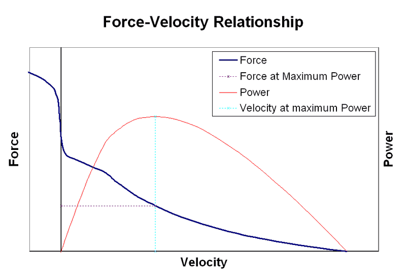

A.T. said:
How did you calculate the contraction velocity of the muscles ##v## ?
I used the "guess and try" method :-)
I guessed several values until I got one that resulted in ~60 cm vertical jump on earth. 60 cm is considered very good for a young athletic individual, but not superhuman.
The ##v_0## was the only value I couldn't find from the literature, but given the other literature values and literature values for a good vertical jump, I felt OK using this rough method.
EDIT: I just noticed that you asked about ##v## and not about ##v_0##. For ##v## I just plugged it into Mathematica and used the NDSolve function to solve the numerical differential equation:
##m v'(t)=F- m g##
Where F is the Hill's model force given above which is a function of the constants ##k,~F_0,~v_0## as well as ##v##.
##m v'(t)=F- m g##
If I understand this correctly, you are assuming the upwards velocity of the human body (v in left side of eq.) equals the contraction velocity of the muscles (v in Hill model).
If that was your assumption, I don't think it's correct. The moment arm of the quadriceps (r) is about 4-5cm, while the length of the femur (R) is 40-50cm:
http://www.gla.ac.uk/t4/~fbls/files/fab/tutorial/biomech/akp2.html
http://www.scielo.org.za/scielo.php?pid=S0038-23532008000200010&script=sci_arttext
So for example at 90° knee flexion, the distance hip-ankle (c) changes about 7 times faster than the quadriceps length (q). I think the relationship can be approximated as:
c = R * 2 * sin(##\Delta##q / (2 * r)) where ##\Delta##q is the change of q compared to c = 0 state (hypothetical 180° flexion)
But note that c'(t) is still not the upwards velocity of the hip, because the ankle is moving upwards too, driven by the plantar flexion of the foot, which in turn is partly driven by the knee extension via the tension in the gastrocnemius muscles that cross both joints.
Bottom line is, you need a musculo skeletal model to computationally estimate the maximal jump height on the Moon. Something similar the one used in this study:

  • #43
I am sure it is not "correct", I was deliberately sacrificing accuracy for simplicity.
I was assuming that the net effect of all of the different lever arms and joint rotations would be to scale the Hill model as a first approximation. I would have preferred an equation which simply described the movement force or even joint torque, but I didn't find any such formulas. Papers which measured the jump force or the knee extension force did not attempt to fit their data to a model, so they could not be applied elsewhere.
http://www.sciencedirect.com/science/article/pii/S0306452213000997
Yes, but I don't have one of those here :-)
I fear that simply ignoring the up to 10:1 leverage the muscles have is really too much of a sacrifice for the result to be useful. But a practical test on an inclined rowing machine (or similar device) would probably be more conclusive than even a complex musculo skeletal model.
  • #48
I agree.
I was actually fairly surprised to find the lack of simple models for functional movements in the literature. The literature seems to focus on either simple models of non-functional movement, highly complex models of functional movements, or non-modeled descriptions of functional movements. I have an inherent distrust of complex models since their great freedom provides too much opportunity to fit the noise.

Faster contraction speed always reduces the force, even if the speed limit isn't reached.
https://en.wikipedia.org/wiki/Muscle_contraction#Force-velocity_relationships
Likes Dale
  • #65
OK, that's good. To account for this, let's say the force is reduced to x of it's value on Earth, then h'/h = (x(1+h/d)-r)/(rh/d). Putting in some numbers, you get x=.9, h'/h = 8.9 and x = .8, h'/h = 7.8.
The other issue with the model of course is that the contraction force is not constant, so you actually want F over the contraction period. The factor x above is more accurately the reduced impulse due to the different force function.
As a next approximation you could use the force/velocity relationship to introduce a velocity dependent resistive force, i.e. the EoM becomes F - mg - βv where β is effectively a drag coefficient. If you looked at standard drag theory (e.g. sinking object in a viscous fluid) then it should be simple to apply. But given that we don't know how the force varies kinematically due to the way the legs generate it (i.e. both the physiology and the machinery - there are at least 3 pivot points in the joints and the force is generated by effectively pulling cables to straighten the joins... non-trivial) it's probably too much model and too little data.
The main point is, assuming no other advantage for the legs in lower gravity it can't be more than 10 (for d=.4, h=.5) and it can be more than 6 (which is based on flawed analysis that ignores that fact that you are able to apply more net force due to less gravity).
