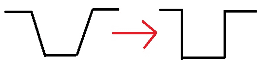

In other words, why are ice cubes trays shaped like the left-hand figure instead of the right-hand one?
If the cube were more square-shaped like the second figure, it would have more volume, thus having more ice in total and keeping the drink cold for longer. I also suspect it would be less likely to slip from people's hands. So why not?

Release, the sloped walls of the tray make it much easier to get the ice out.
Volume of ice is only one consideration in engineering an ice cube tray. I can see the offset shape (1) provides more surface area for thermal transfer and, perhaps more importantly, (2) facilates removing the cubes from the tray.

Working with the premise to maximize 'functionality', the items I can think an engineer would consider during design would be:
1) Ease of filling.
2) Speed of making ice.
3) Ease of removing ice.
4) Chilling performance.
These are the goals I can think of. There are easy answers to items when taken one at a time, but best solutions for each item can contradict best for others. Maximizing surface area is good for #2, and also #4 but only if rate of chilling is considered better than lifespan of ice cube. Trapezoid assists in #3, and I'm not sure, but maybe slopes also help ease of filling (#1) by reducing 'backsplash'...? Not sure about that one!
So unless you can think of any other 'goals' of the utopian ice cube tray, I'd say these four topics are what the engineers are doing max/min analysis on based on the goals/bias of the end result.
They might be easier to manufacture that way. But that's just a guess. I was also thinking that because ice expands, the cubes might automatically eject themselves a tiny fraction during the freezing process, making them easier to remove.

And the marketing department could or would negate items 1,2,3,4 for look, packaging, return on cost of production, sex appeal and whatever criteria they would consider to make their product stand out from the rest. Engineering would be predominant only for "can we make it" and how much does manufacturing cost".
The shape also helps with stacking, keeping transport costs (from whatever Chinese manufacturing plant actually makes them) down.
I have the impression that some ice making machines produce cubes, not trapezoial shapes. The clear ice cubes are made by repeatedly layering thin films of water that then freeze to form the cubes.
The shape not only helps release the ice from the tray but it also helps release the tray from the moulding machine that made the tray.
