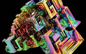

Google pictures of bismuth. If this isn't colorful, then nothing is. E.g. on http://unitednuclear.com/index.php?main_page=product_info&products_id=1169

Oh this is nice but I did not saw anything like this.

The color here comes from interference effects from the variable thickness passivating oxide layer that builds up on bismuth. Bismuth itself is dull gray.
