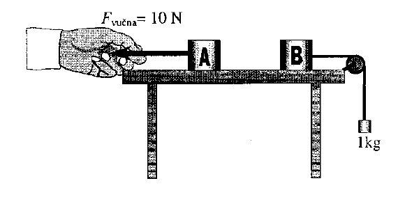

question is which body A has greater acceleration?
F=ma
Apparently body A has greater acceleration and I don't get why. Can someone please explain.
It's stated to take g=10/s^2.
Both bodies have same mass.
Nothing about rope elasticity is added, and nothing about the pulley. So I assumed they are both massless, and no friction between them.
Also, the table surface is frictionless.
Thank you
The pulley and string may be massless, but the 1 kg mass is definitely not massless!

yeah but, 1kg×10m/s^2=10N so both forces are the same, masses the same, thus accelerations are the same

No, they are not. If the tension in the string were 10 N then the net force on the 1 kg mass would be zero and it would not accelerate.

Yeah but, the 1 kg mass is not massless.

But the bodies(A and B) are not connected, if that is what you are saying.

The 1kg mass is connected to B.

Okay, but why does that matter? 1kg is falling with 10N pulling B with 10 N, same force as the hand is pulling A

It;s fundamental.

What does that mean?

Is it? What about Newton's third law? If the 1 kg mass pulls B with a force of 10N, then B pulls the 1kg mass with an opposite force of 10N, and the 1kg won't move, as it has a zero net force acting on it.

May I suggest drawing free body diagrams of each mass ( A,B, and 1kg) for us to examine together?

ohh. I figured. How stupid am I :headbang::headbang::headbang::headbang::headbang:
Thanks everyone. :bow:

Like, I never draw those. And the best thing is that I have solved whole bunch of problems with like these, but they were like, calculate acceleration. I did take a brake from physics for 2 weeks or so, but still, like I knew how to do these problems. Is it normal for people to forget that fast?

It's not that big a deal. It's tricky like that on purpose. Thats why its important to draw a FBD, because it becomes apparent when to "see" the forces.
