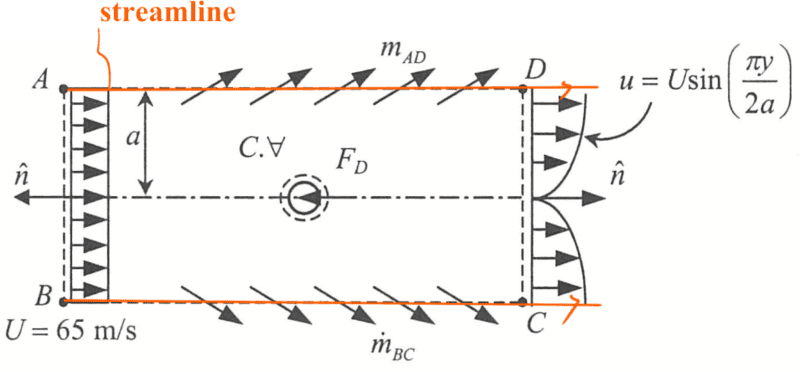

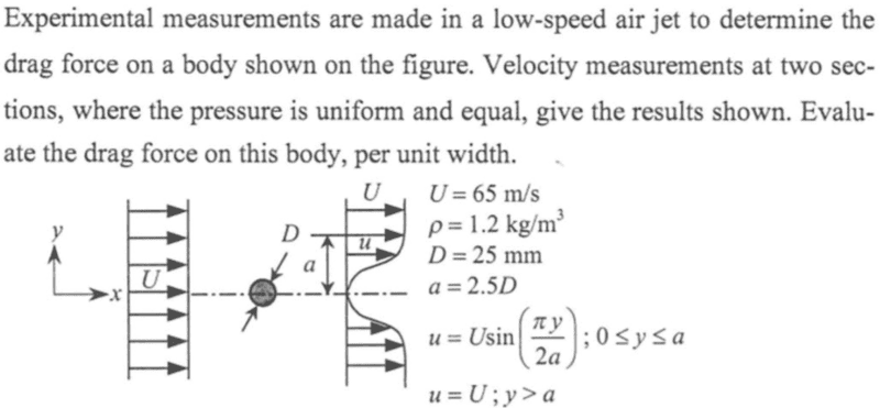

Q: Why can a fluid that satisfies the continuity equation for mass conservation cross streamlines?

So your issue is with what is happening to the flow as it passes around the sphere. Where the streamlines are being squeezed together?

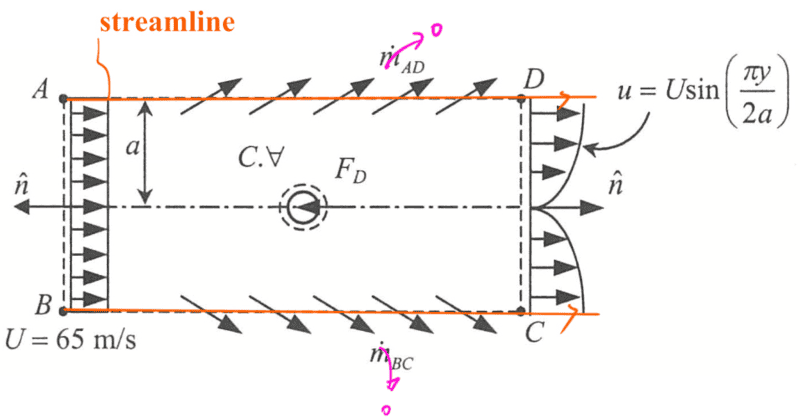

Why can ##\dot{m}_{AD}## and ##\dot{m}_{BC}## cross streamlines instead of being equal to zero?
I don't think fluid elements are crossing streamlines here. Streamlines are being divided, that not necessarily mass exchange between layers.
Imagine what is happening between streamlines. In steady flow a group of molecules are all together doing the same thing as the others in the streamline. The streamline is a boundary that is saying things inside it are doing the same thing on average. Then, they are presented with an obstruction, something that forces convective acceleration. That group of fluid particles is forced to divide into new groups, or layers such that the mass flowrate of that original grouping is conserved. In reality there is always some small turbulence from the change, but in theory the layer that "was one homogeneous unit" splits into new layers each having their own homogeneous velocity. Past the obstruction, they may settle back into the original formation.
Thats what I think is happening.

If fluid elements do not cross streamlines, then the diagram below would conflict with the principle of mass conservation. Is this an issue with the question or with my understanding?
There are other streamlines in between the two drawn on the diagram.
Is it related to ##\dot{m}_{AD}## and ##\dot{m}_{BC}## not being equal to zero?

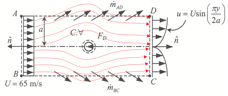

I think the diagram is just saying the total mass flowrate splits around the sphere equally. I think they are just trying to illustrate it with the angled arrows. half goes up around, half goes down around.

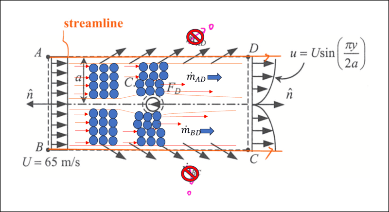

I hope you can draw a simple diagram to assist in explaining, for better communication and understanding.
Likes tracker890 Source h
erobz said:
Thank you for the excellent and detailed explanation, along with my understanding diagram.
Thank you
Your welcome!
I'm not saying our diagrams are entirely accurate, but I think you have understood the idea.
The obstruction in the flow forces some of the mass to spill out of the perfectly cylinder shape that has been represented.
While it recovers back to the initial state, the flow downstream the ball slowdowns.
That slowing moving mass becomes an additional physical obstacle, around which the surrounding fluid tries to move.
Pushing the layers away from the obstacle is the easiest way, but those (also moving) layers have inertia and resist that push (perpendicular to the flow).
Then, most of our molecules (that could not spill out into the outer layers), caught in between obstacle and outer layers, must increase velocity to keep mass flow balance (upstream-downstream).
In your diagram,
Flow mass AB cross section = Flow mass AD-BC cylinder wall + Flow mass CD cross section
Note the conical constant volume (cv) streamline shape represented in figure P3.44 in one of your reference links.
The closer to the obstruction the limits of the control volume are established, the more mass will cross it out in a transversal way (just to eventually cross back to the fill the void and return to be calmed still air).
