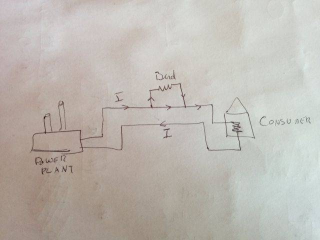

EDIT: If we model the bird has being a resistor in parallel on the circuit (each "foot" being one end of the resistor), then current actually flows continuously trough the bird, but only in a very small amount if the bird has a high resistance. Thus the bird is neither at 0 V or 100 kV. But there is a small potential difference between each of the bird "foot". Is this approach correct?
DoobleD said:
Take a bird at 0 V (with respect to ground) flying above a power line at 100 kV (still with respect to ground). The bird now lands on the wire. The bird is NOT shocked (see the article mentioned above as well). Current does not flow?
When the bird lands it's voltage (wrt ground) changes from 0 to 100kV. Some current will flow because the bird has capacitance wrt ground. Don't forget most high voltage lines are AC not DC. Fortunately for the bird the capacitance is small and at 50 of 60 Hz the impedance is quite high.
Elsewhere on the internet I've seen a comment that the current can be enough to make birds feel uncomfortable so they are rarely seen on 132kV lines and never on 400KV lines. I don't know if that's true.
DoobleD said:
EDIT: If we model the bird has being a resistor in parallel on the circuit (each "foot" being one end of the resistor), then current actually flows continuously trough the bird.
No that's wrong. No current flows because both feet would be at the same voltage1. The bird would only be in trouble if he stepped off the line one foot at a time onto a wet tree branch or metal roof (not that you should build a metal roof that close).

I think that was DoobleD's point. The resistance of the wire between the bird's feet is tiny compared to the resistance of the bird, so DC-like current flow through the bird is tiny compared to the current flow in the wire.
Thank you guys for your answers.
I think I am missing something when you both talk about capacitance and AC here...All I know regarding AC current with capacitor in a circuit, is that a capacitive reactance is produced, delaying the current with respect to voltage. Does this has anything to do with what you discuss? What is this thing of capacitance with the Earth (and the bird?) you are referring?
It is still not clear to me what happens to the bird.

Simply (and one can over complicate things) current flows between two points when there is a potential difference between those two points.
If the bird's feet are at the same potential, it does not get zapped.
If the bird opens its wings, and touches the earthed-steelwork of the tower carrying the conductor, then there is a potential difference between its feet and its wings, and it gets zapped.They don't like EHV conductors because the air immediately around the conductor is charged. This gives a very steep voltage gradient around the conductor. As the bird gets closer, it starts to feel this (just like you get a tingle if you lick a 9V battery!) and flys away.
So the bird cannot be modeled as a resistor in parallel when it has only the two foot on the same wire? I find it hard to believe. No current at all through it, even a tiny? Crappy drawing below. :D (Haven't draw transformers etc for simplicity)
Sure it can - it's just that the voltage difference between the wire under the left foot and the wire under the right foot is fairly small, so the voltage across the bird/resistor is also small.

So there is a tiny current? Even too small for the bird to actually notice.
the bird is connected at two points...what is the potential difference between these two points?
just say (for arguments sake) the volt drop along the conductor is 0.5mV per metre and the distance between the birds feet is 2cm
the potential difference between the birds feet is then 10 uV.
now say the birds resistance is 100 ohms (I don't know what it is, it could be thousands)
so the current flowing is i = v/r = 100 nA. This is about as close to zero as you can get
Likes DoobleD

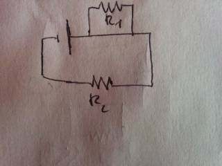

Oh sh*t, you are right. I think I just completely got something wrong: the bird is not actually in parallel on the circuit. If I replace the bird by a voltmeter and if the wire is a perfect conductor, the voltmeter does read 0 V because no current is going through it.
Is this finally correct?
well it IS in parallel, just like the voltmeter is in parallel, but it is in parallel over a voltage of 0V (or 10 microvolts as we quickly worked out earlier)
Arrr, and I thought I was starting to understand EM and circuits! Let's go back to the basics.
In the picture below, are those statements correct (assuming perfect conducting wires):
1 - R1 is in parallel with the wire below it
2 - But R1 and R2 are not in parallel with each others (they are not both linked directly to the + and - sides of the battery, only R2 is)
3 - Anyway no current flows to R1 (makes sense, why would current go to an additional resistor when it can avoid it)
1) yes
2) R1 and the wire it is connected to are in SERIES with R2 (you can replace R1 and the wire it is connected to with a single resistor of LOWER resistance).
3) Yes - you have short circuited it
Assuming the wires are perfect conductors, to replace R1 and the wire below it while still having the same situation, we would have to replace them by a single perfect conductor (or equivalently, simply remove R1)?
if you wanted to replace R1 and have the same situation, you would replace the wire with a wire of a bigger x-section
Two wires of 1mm^2 each in parallel carries the same current as one wire of 2mm^2
Putting wires/conductors in parallel allows more current to flow.
