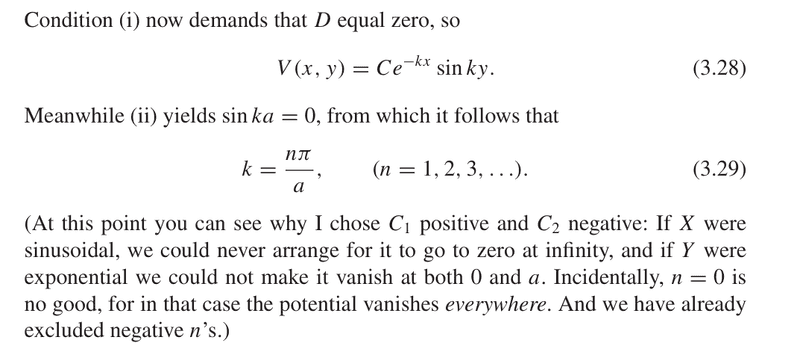

Why can't n be negative? Is there a reason for this? My thought is that if n is negative, as sine is odd, the negative gets absorbed into C, a constant. Is this correct?
Would it be equally correct to let n be a negative integer?
Thank you
Because ##\sin (-x) = - \sin(x)##, the solutions for negative ##n## simply repeat the solution for positive ##n##.
PeroK said:
Because ##\sin (-x) = - \sin(x)##, the solutions for negative ##n## simply repeat the solutionf for positive ##n##.
But with different constant, though?
The constant ##C## is arbitrary.
The solution of the problem is $$ V(x,y)=(Ae^{k x}+Be^{-k x})(C\sin(ky)+D\cos(ky)) $$ where ## k>0 ## and where the condition (iv) ## V\to0 ## as ## x\to\infty ## requires that A is equal to zero.
If ## n ## is negative ## -k ## will be positive and the part, which has already been excluded from the solution by ## A=0 ##, will be included into the solution again and the condition (iv) will be violated.
