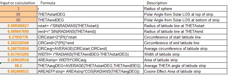

So, I would compare a hemisphere to a circular flat panel of the same radius. The total area of the hemisphere is twice the area of the circular flat panel of the same radius, but one hemisphere of a sphere is always presented to the Sun without a tracking mechanism. However, not all of the area of the hemisphere is normal to the Sun so its output will not be twice the flat panel. Cosine error will accumulate over the surface of the sphere, and calculating this would require integrating the cosine effect over the hemisphere.
Since my calculus is rusty, I drafted a numerical integration in a spreadsheet over half a hemisphere, and came up with a factor of 0.635. That is, the effective illuminated area of a hemisphere is 0.635 the geometric surface area. Since the hemisphere has twice the surface area of a flat disc with the same radius, the equivalent illuminated area will be 2 * 0.635 = 1.27. Thus, a spherical solar array in space will always produce 1.27 time the power output of a disc flat panel with the same radius without any tracking mechanism, but of course the sphere contains 4 times as many solar cells.
I think engineers have figured this out, and the results are obvious if you just look at the way solar panels are designed and installed; and also what's available for purchase.

The main thing I was hoping to see comments on was my math on how the cosine effect applies to a hemisphere.
You lost me when you said half a hemisphere. Did you mean half a sphere? Because half a hemisphere has the same area as a circle of the same radius.

The lower power in the middle of the day is due to the single axis oriented horizontally, North to South, so there is Cosine effect due to the Sun angle at Noon from the Latitude. At some time during the morning and afternoon, the single axis tracking will align the panel normal to the Sun.
I integrated form 0 to 90 degrees, half a hemisphere, instead of -90 to +90 degrees, a full hemisphere, and assumed symmetry from this arc to a hemisphere. I am not sure I did this correctly, which is why I am asking for someone to check my math.

I completely redid my numerical integration spreadsheet, and the results seem to support that the Cosine Effect on a hemispherical PV array would have the same output as a disc with the same radius normal to the light rays from the Sun. I made a prototype spreadsheet with the formulas for two adjacent latitude lines. The diagram is at this link:
https://en.wikipedia.org/wiki/Spherical_coordinate_system
Spherical Latitudinal Strip Solar Array with Cosine Effect.
Rays of sunlight are parallel to the polar z-axis.
The spreadsheet has 91 rows, with the first column the THETA degrees from 0 to 90 in 1 degree increments. Each row calculates the area of a strip of latitude 1 degree wide. The sum of the rows for r=1 is extremely close to pi, and given the granularity error of numerical integration, this supports the hypothesis that the Cosine effect area of a hemisphere is the same as the area of the equatorial disc.
For a spacecraft, a spherical array of PV panels will provide the same solar power as a disc of the same radius without a Sun tracking mechanism, but at a cost of 4 times the number of PV panels.
