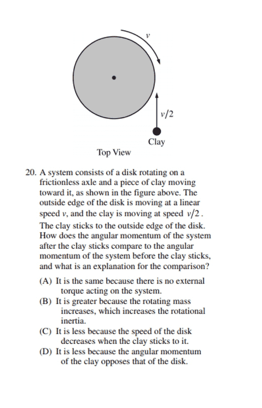

1. A system consists of a disk rotating on a frictionless axle and a piece of clay moving toward it as shown above. Outside edge of the disk is moving at a linear speed of V and the clay is moving at speed v/2. How does angular momentum of system after the clay sticks compare to the angular momentum of system before the clay string?
A) It is the same because there is no external torque acting on the system.
B) It is greater because the rotating mass increases, which increases the rotational inertia.
C) It is less because the speed of the disk decreases when the clay sticks to it.
D) It is less because the angular momentum of the clay opposes that of the disk.
I'm trying to prove my teacher wrong but I can't necessarily figure out how to invalidate his argument. He is trying to argue that the clay creates a torque against the wheel, thus making A not the correct answer. However, my own knowledge and every example of this on the internet chose A as the correct answer (my teacher believes the answer to be C).
2.
So I guess my question is... Why doesn't the torque of the clay cause a decrease in momentum?3. I believe it is because the wheel exerts an equal and opposite amount of torque on the clay, thanks to Newton's Third Law, but I am not sure if this is correct. As stated before, I believe the answer is A, but my teacher argued that the answer is C.

The correct answer is clearly (A). The problem says "the angular momentum of the system", which includes the wheel and the clay. Your teacher is right that the clay exerts a torque on the wheel, thus transferring angular momentum from the clay to the wheel. But there is no net torque on the whole system, so the angular momentum of the whole system is conserved.

Thank you, I'm waiting for a response from my teacher to see if he'll finally believe me. So, the torque is what transfers angular momentum in this system? Someone on reddit told me that the wheel would create an equal and opposite torque... is this correct?
1. You can find the angular momentum of the wheel before the clay sticks to it. The angular momentum will be in the direction into the page.
2. You can find the angular momentum of the clay before the clay sticks to it. The angular momentum will be in the direction out of the page.
3. the total system angular momentum before the clay sticks to it: This will be L from 1. minus L from 2. (into the page)
4. Now find the moment of inertia for the clay and the wheel together.
5. Allow the velocity of the flywheel after the sticking together, call it v(final) . Find the angular momentum of the clay and wheel together from the moment of inertia and the radius and the v (final)
6. Now equate the angular momentum before the sticking to the angular momentum after the sticking. You will find the final velocity of the wheel is less than the initial velocity of the wheel.
Upshot: Bottom line: If you follow the steps, you can verify the following conclusions. Even if the angular momentum is the same (conserved), the final velocity of the wheel could be less than the initial velocity of the wheel. (You are showing this) Answer C (even if it is true) does not require that the angular momentum is not the same. Answer C does not nullify answer A, and does not require the angular momentum to change.
The question is deficient in that it fails to specify the axis for measuring the angular momentum. If we were to choose an axis displaced to left or right of the axle then there would be an external torque coming from the axle. Glossing over that, A is clearly the intended answer.
Yes, there will be equal and opposite linear impulses at the point of contact, so equal and opposite torques about the axle.

You miss my point. The wheel will not rise at all since it is mounted, securely one trusts, on an axle. The axle will exert a downwards impulse on the wheel equal and opposite to to the upward impulse from the clay.
If you choose an axis left or right of the axle then that impulse will create an impulsive torque about the axis.
Fair enough. I did not consider reaction forces the mounting would have to apply to the wheel to keep it stationary after the clay attached.

So do you agree now that the angular momentum of the system about the axle as axis is conserved?
Now I do. Because I can see how a mass with a changing angular velocity and changing distance reduces to the constant angular momentum. Otherwise, I was having trouble seeing how a mass at a distance of, say, 100,000r, on a "nearly" radial approach to the axis and with "near zero" angular velocity, had the same angular momentum, or how the angular momentum with respect to a series of axes arranged parallel to the linear motion would be identical at all times for all axes.
If I start with ## d \sin \theta ##, the effect of distance and angle is apparent.
Likes haruspex
PeroK said:
Although, as @haruspex has already mentioned, there is an external force; and, whether that external force represents a torque depends on the point about which we are considering the AM.
AM is conserved about the centre of the disc; but not, for example, about the centre of mass of the system.
Ah ok. The axle is included in the system but the bearings and it's mounting are not. So an external force crosses the boundary
