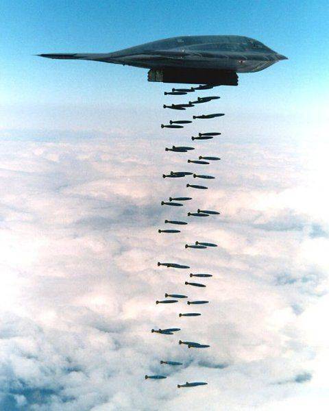

why does the bombs and the plane form a "straight line" in the y-axis? the plane is accelerating away in the x-axis at a certain speed, so my thinking is that the bombs that were released should be some distances from the plane
Why do you assume the plane is accelerating?
Ukitake, you have to be careful with your terminology around here. Stop and think about the motion of the aeroplane and its contents. Is there acceleration? If so, what vector?
what is most likely is that the plane is maintaining a constand speed and one would presume that as the bombs are dropped and so no longer benifit from the engine which is requireered to overcome primarily air resistence and keep the plane at a constant speed, the bombs would be expected to descelerate due to air risistence (so if you took the bomb as your point of reference you *could* say that in relation to the first bomb the plane was accelerating, although this would be a funny way at looking at it). so given all this you would presume that the first bomb dropped would descelerate first and so at the moment the second bomb is dropped the first bomb has decelerated and so is someway behind the plane and second bomb, so bomb after bomb you would expect that the bombs trail off behind the plane. But in answere to you question it is most likely that simply the bombs are dropped in very quick succesion and this combined with their high density and relitivly low air resistence meens that they will decelerate slowly and so that first period of desceleration between the time of the first bomb being droppped and the last bomb being dropped is insuficient for the bombs to trail out. otherwise there is the possability that theses are very smart bombs and employ a propulsion system combined with a speed controller that maintains the bomps at a constand forward velocity.(unlikly tho)

hmmm...hard to tell if there is acceleration but i assume there isn't any acceleration
on 2nd thoughts i think there is no acceleration which is why the bombs fall in 1 line
i rem an example about a car moving at constant speed and someone fires a bullet upwards and ignoring all other factors where will the bullet land?
and the question gave 3 choices 1) bullet falls ahead of the car 2) bullet falls behind the car 3) bullet falls back into the barrel
bullet will fall back into the barrel becoz the bullet is traveling at the same speed as the car in the x-component and all other factors are ignored
Sounds good to me.

The bombs in that picture are trailing a tad bit, with the lower ones trailing more. I'd imagine this is for the reasons josh444 brough up.
Good point, Tony. That effect, however, is a direct result of air resistance acting upon the bombs which have no forward propulsion mechanism. In vacuum, they would drop directly.
