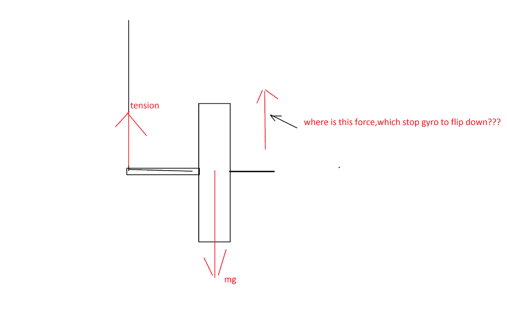

he said torque is in direction into the board,but this torque don't have upward commoment so what keep gyroscope to not fall down because mg pull him down??so waht is is force which oppose to gravity??
i understand that torque into the board cause gyroscope rotating in cricle(gyroscope precession) but what keep him to not fall down?
Aeronautic Freek said:
so waht is is force which oppoese to gravity??
That is the upward force at the support. Without that force the gyroscope would fall like normal.

i don't understand ,can you show free body diagram of rotating gyro?
upward force at support exist even when gyro is not rotating but than gyro fall down..so rotaing gyro must produce some "new force" which act somewhere out of support if gyro is not falling.

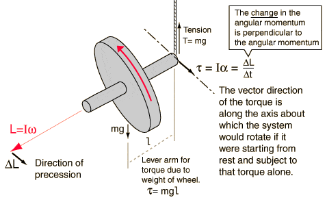

From: http://www.hyperphysics.de/hyperphysics/hbase/rotv2.html
If it falls down then the froce is not the sameHere some good explanations of gyroscopic precession:

No new force, but the force at the support is less if it is falling than if it isn’t falling.

i stil don't understand what keep gyro to not to flip down,(like do when is not rotating)...
Can you clarify? Are you interested in why it doesn’t fall (linear motion) or are you interested in why it doesn’t flip (rotational motion)?
Up until this post you have been saying “fall” so I assumed you were interested in the linear motion and answered accordingly, but here you say “flip” so now I am unsure what you intend.

When i said "falling" i don't mean on faliing completely to the ground,i mean to flip/tilt(ROTATION MOTION) gyro down ,like gyro do every time when is not rotating...
(gyro can never fall down compltley becuase it is connected with rope ...i understand that..)

OK, then you were using the wrong words. You want to ask about flipping or rotating not falling and you want to ask about torque not force.
The torque is horizontal so the angular momentum moves in the horizontal plane. To make it move down would require a downward torque. So the torque is in the wrong direction for it to flip down.
gravity act at center of gyro mass, so downward torque = mg x L
how do you mean torque is in the wrong direction to flip it down?

First, you need to understand that the reason the wheel falls down when not rotating is because the torque creates a rotational motion of the wheel, centred at the end of the rope. If we don't want the wheel to fall, we need to find out a method to "consume" the torque. In this case, the rotation of the wheel does the job.
The gravity exerts a torque perpendicular to both the force vector and the arm which is the axle, on the wheel of the apparatus. Since we know that an external torque can change the angular momentum of the system, and the torque is perpendicular to the direction of the angular momentum, the torque simply changes direction of the angular momentum. As a result, the torque causes the wheel to rotate about the tip of the hanging rope and does not make the wheel fall down.
If you think my explanation is unintuitive, feel free to ask me to draw some diagrams for you.

yes we must have some "righting moment" to counter dowanward torque caused by gravitiy(mgxL)
so yes you can draw some diagrams!
No. The downward torque is 0. The ##m \vec g \times \vec r## torque is horizontal.

Gravity can never produce a downward torque. Gravity is vertical and torque is always perpendicular to the force. So a torque from gravity is always horizontal, never downward

yes obviusly net downward torque is zero,because gyro is not flip down,but this is non intuitive,maybe here starts all problems to me...
it is very strange to imagine where" righting moment" coming from, which counter gravity and make gyro to not flip down,,,,

You mention “net torque” and “righting moment” which makes me think you believe there are two torques involved. There is only one torque, the torque from gravity, and it points horizontally. There is no second torque to produce a net torque or a “righting moment” (whatever that is)
The torque is horizontal so the angular momentum moves horizontally.

Because in that case the gyroscope initially has 0 angular momentum. So increasing the angular momentum horizontally involves increasing the amount of spin about a horizontal axis, which is done by flipping down.
The difference is that in the spinning case the gyroscope starts with a very large angular momentum perpendicular to the torque. So instead of increasing the angular momentum it just turns it.
