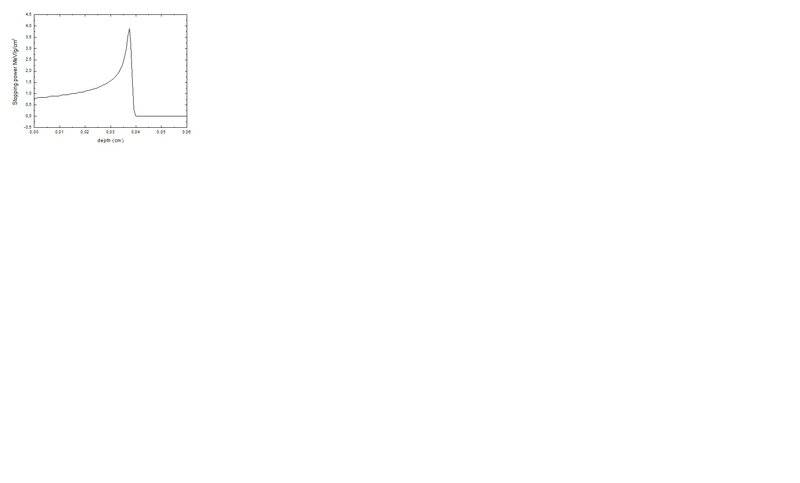

Hi,
I don't think that F1 or F4 are a good tally to calculate stopping power. F6 is better.
For my part I would have used a mesh tally.
See my input file (Rmesh pedep will return MeV/cm3 in the mdata file).
the result is plotted in the image.
The example is given in the book that I indicated to you here: https://www.physicsforums.com/threads/nuclear-engineering-mcnp5.1047564/
  • SPCr.txt
    SPCr.txt

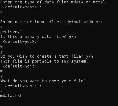

For me, gridconv.exe is not working correctly. As the output, the mdata.txt file appears to be 0 kb in size. why?
  • #31
What options are you choosing? The file is written about half way through a lot of questions when I try it.
Likes emilmammadzada
  • #32
mcnp5 doesn't have many options for me, gridconv.exe asks for input file name and then output file name. It asks if it's binary.
  • #33
In gridconv, at the question "Enter name of input file" you must put the mdata file (binary file) and not the mcnp file. To create mdata file you must run the input file (for example SPCr.txt in post 15) with mcnp and the mdata will be create (mdata or mdatb or mdatc or ...).
hope it's help.
  • Love
Likes Alex A and emilmammadzada

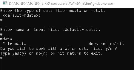

Should mdata and gridconv be in the same folder?
  • #35
no gridconv in in the bin folder and mdata in the files folder
  • #36
I got such error in separate folder.mdata and gridconv are in separate folders

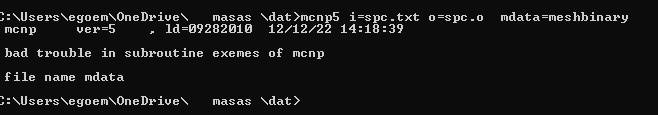

and if you run
MCNP5 i=spc.txt o=spc.o
  • #46
Now it's been like this
  • #47
of course ! MCNP5 does not transport proton !
you must try with MCNPX or MCNP6 !
