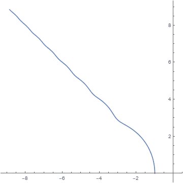

I think I did not phrase my question in the way I intended. My question is that if you apply a constant force at a fixed point on an unconstrained roller, as the diagram (##\hat i \to \hat j## and diagram was not drawn to scale, sorry!) below for an example, what will happen.

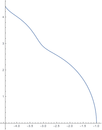

I think I already found an answer to my question. I used MMA to plot the path traveled by the roller. I set all parameter to 1 and set the time range from 0 to 5. This is what I got:
Setting time range from 0 to 10 gives me this:
Long-term behaviour:
(As you can see, the motion gradually becomes linear, which is interesting.)
However, I do not understand why it starts from (-1, 0) instead of (1, 0). So I am going to upload my work which I would like you to inspect, thanks. (I realized that the vector-valued function starts at (1, 0) instead of the origin when I was running.)
Follow-up:
My work is as follows:
Assuming that the roller starts from (0, 0), the initial force vector is ##\hat j## and r=moment arm.
$$\frac {\mathrm{d^2} \theta} {\mathrm d {t}^2}=\alpha$$
$$\therefore I\frac {\mathrm{d^2} \theta} {\mathrm d {t}^2}=rF \: (F \: is \: the \: magnitude \: of \: \vec F)$$
$$\theta(t)=\int \int \frac{rF}{I} \mathrm d t \mathrm d t$$
$$\theta(t)=\frac{rFt^2}{2I}$$
Now I am going to use a vector-valued function to express ##\vec F##
$$\vec{F}(\theta)=-F \cdot \sin(\theta) \hat i + F \cdot \cos(\theta) \hat j$$
The Sin function is used to express Fx because ##\cos(\theta + \frac \pi 2)=-\sin(\theta)##. Likewise, Cos function is used to express Fy because ##\sin(\theta + \frac \pi 2)=\cos(\theta)##. (Adding pi over two because the initial force vector is perpendicular to the x axis)
$$\therefore \vec{a}(\theta) = -\frac F m \cdot \sin(\theta) \hat i + \frac F m \cdot \cos(\theta) \hat j$$
$$\therefore \vec{x}(t)= \int \int -\frac F m \cdot \sin(\frac{rFt^2}{2I}) \mathrm d t \: \mathrm d t \: \hat i + \int \int \frac F m \cdot \cos(\frac{rFt^2}{2I}) \mathrm d t \: \mathrm d t \: \hat j$$
Then I used MMA to solve these double integrals.
Set all parameters to 1:
Evaluate the i integral:
Evaluate the j integral:
Plot:
(the solution to the j integral is added by 1 because the initial position of the force is (1, 0) and the initial position of the CM is (0, 0))
And this gives me the graph.

Now I see what exactly you had in mind in post #22. The application point of tangential force follows the rotation of the disk, which means that the tangential force keeps changing direction. Still this means that the tangential force has some sort of periodicity and i would expect this to show up in the plots. You 've setup all the parameters equal to 1, which doesn't help to spot the periodic behavior of motion.

Leo Liu said:
Just one more question -- if a constant tangential force is applied, will it give us a circular trajectory?
A constant force is also constant in direction. Are you asking what happens if a constant force is applied to the same point on an object? If so, what would that force be tangential to?
  • #40
You see the periodicity at the start, but angular velocity increases so the periods and amplitudes become smaller. After a while it looks like linear motion, but if you would zoom in, you would still see little wiggles.
Likes Klystron, vanhees71, etotheipi and 2 others
