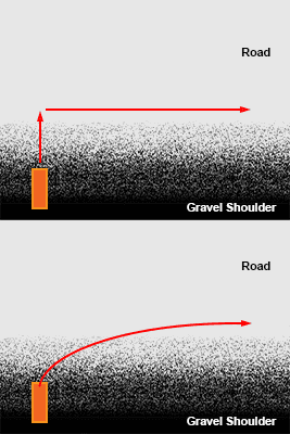

DaveC426913 said:
Maybe a primitive comparison to a mundane scenario:
When you finish fixing a flat on the loose gravel shoulder of a highway (let's assume it's empty), do you:
- pull straight out onto the road then make a right turn and begin accelerating? Or do you
- pull out at an angle so that an ever-increasing component of your movement is in the direction you ultimately want to go?
(Oh, and the road is tilted, so that you have to steer to the left, just to keep from sliding back into the gravel shoulder.)
Very good analogy. Thanks DaveC.

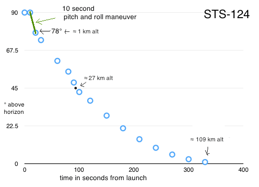

My son also noted that when Max Q is announced, the shuttle is way beyond 45 degrees (closer to horizontal then vertical). So the observation that the shuttle is going "partially sideways" way before it's out of the relevant atmosphere is confirmed by that.
It's worth noting that this is incorrect. At max q, it's flying at a flight path angle a bit less than 45 degrees off vertical (though it's pretty close to 45 at that point), as can be seen in the STS-116 ascent data here: https://spaceflightnow.com/shuttle/sts116/fdf/116ascentdata.html
As for why this is done? Rockets weigh a lot and have a lot of thrust. Thus, aerodynamic losses are actually fairly small. On the other hand, gravity losses (which occur due to the thrust fighting gravity while flying vertically) are much more significant. As you pitch away from the vertical, gravity losses shrink, since more of the thrust is accelerating the rocket and less is being wasted just holding it up. From what I can find, out of a total ΔV budget of a bit over 9km/s, the space shuttle lost about 107 m/s to drag loss, and about 1222 m/s to gravity losses, so this gives a good idea why you would want to start accelerating away from vertical quickly, in order to reduce the gravity loss even at the cost of some drag, since gravity loss is 10x more significant anyways.

It's basically just a function of trigonometry. If your rocket is thrusting with 1.4 times the force of the rocket's weight (pretty standard right after liftoff), and you're aimed straight up, your net acceleration is 0.4G, with 1G loss (most of the thrust is wasted just holding the rocket up). If you've got the same scenario but you're pitched over to 45 degrees, the vertical component of the thrust is equal to the rocket's weight, so you have zero vertical acceleration, and the horizontal component is 1G (each is equal to 1.4/sqrt(2)). Even though the vertical component still loses 1G, the rocket is only accelerating at a rate 0.4G less than what would occur in a zero-gravity environment, so it is gaining velocity more efficiently.
Also, it's true that gravity loss goes to zero as you approach horizontal, but your ability to do that is constrained by the requirement that the rocket gain altitude and not crash during the ascent.

Well; note it also drops to zero as your speed rises to orbital speed. That's the whole reason you are gaining the speed!
The equation for centripetal acceleration is a square function of velocity, so for your 1.4g engine output example, at half orbital speed the angle for zero vertical acceleration is 32 degrees instead of 45.
This is part of the reason why the total gravity drag is so small (about 15% of final speed) despite starting so large (about 67%* of takeoff acceleration).
*Note: I'm uncertain of that number. The profile I posted lists 1.5g, which I initially assumed was speed change, but looking at the speed numbers it appears to be total (0.5g of speed change). That's lower than I thought and also doesn't make sense as they also say acceleration start at 0, instead of 1. But I think I need to trust the speed numbers.

That's about right - most rockets lift off with a thrust to weight ratio of between 1.2 and 1.6 to 1, so they waste most of the thrust just fighting gravity. However, note that the vast majority of the rocket's weight is fuel, so the thrust to weight ratio improves dramatically as the fuel burns away. As a result, most rockets finish their burns at 4-6G of acceleration, in some cases even throttling down to reduce structural loading as the acceleration climbs. This also helps minimize gravity drag later in the burn, since 5G at a nearly horizontal flight path angle really has next to no gravity loss.

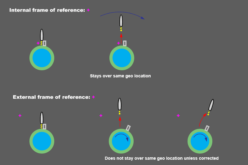

Rockets tip shortly after launch so as to gain the benefit of Earth's rotation added to final orbital speed., so they are accelerating horizontally, with the Earth's spin, as they climb, an eventual 'permanent' horizontal flight is what is the desired end (orbit).
I did have another thought: Military missiles, typically cruise missiles, launch vertically for a short distance and then attitude jets rapidly kick it horizontal, or close to it. Those critters also tend to have wings which deploy, so they are, in effect, launching a jet airplane vertical, tipping it over after launch and deploying wings for long flight. If THIS kind of rocket is what the kid asked about, then it is a whole different critter than orbital mechanics of launch as it is an 'in atmosphere' weapons launch instead.
  • #65
They have that benefit already on the platform.
Likes russ_watters
  • #66
True, though in order to fully utilize the pre-existing velocity, one needs to thrust parallel to it rather than perpendicular.
Likes Steelwolf
Perhaps I missunderstand your answer but rockets get that benefit just standing on the pad. It's and advantage of launching nearer the equator than the poles.
I don't see how turning horizontally increases that.
  • #69
Vector addition of velocities. You get the biggest increase if the added delta v is parallel to the existing v.
Likes Steelwolf
