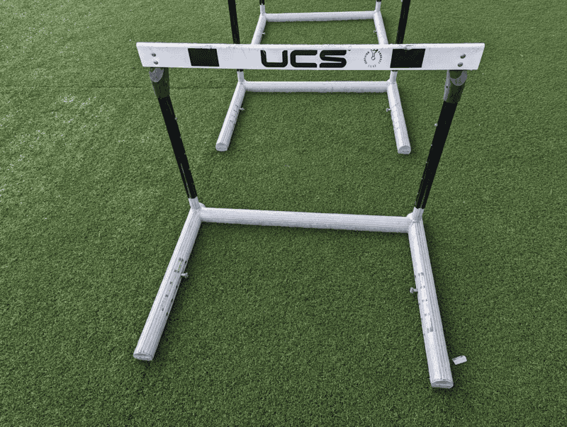

I saw these hurdles at a track meet I was working a couple weeks ago, and I'm wondering what the adjustable bases are used for. Most hurdles come with adjustable height settings, but these are the first ones I've seen with adjustable bases.
From Google searching, I think they are the UCS 5000 series, but the "technical specs" document for them does not seem to explain what the base adjustment would be used for. Any ideas?
https://www.ucsspirit.com/products/...ate-5000-series-hurdle-with-weight-selector-1
https://www.specucsspirit.com/_files/ugd/35e5db_0feee22e0c654228878f54a3ed76e1d4.pdf
Seems like it would be the weight selector in the title on the website. I assume the pin is connected to some heavy block inside the base tubes that can be moved closer to or farther from the uprights, making it easier/harder to knock over the hurdle. Weird it isn't in the technical spec since it seems be a non-cosmetic distinguishing feature.

Okay, I just got a great reply back from my USATF friend:
Ryan said:
You are correct! USATF rule 168.5 defines hurdle construction specifications, which defines a 3.6 to 4.0kg horizontal force required to push over the hurdle.
The taller the hurdle, the less horizontal force is needed, so some (expensive) hurdles like these have a counterweight you can move forward or backwards based on the height of the hurdle to achieve the right push-over force.
In reality no one actually measures this or checks the counterweight settings unless it's a national championship, so most schools just use fixed-weight hurdles.
