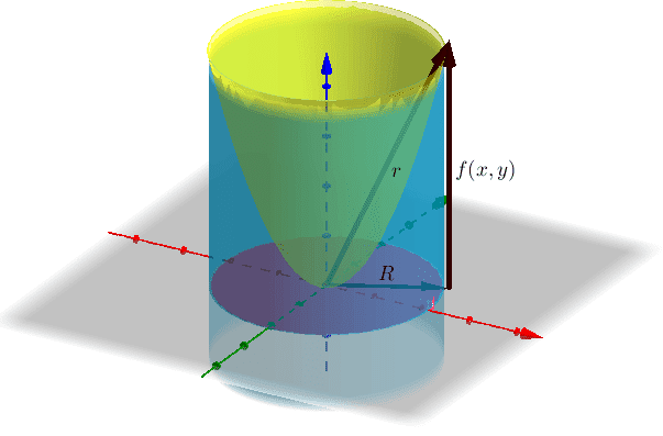

Let ##V'## be the volume of dipole distribution and ##S'## be the boundary.
The potential of a dipole distribution at a point ##P## is:
##\displaystyle\psi=-k \int_{V'}
\dfrac{\vec{\nabla'}.\vec{M'}}{r}dV'
+k \oint_{S'}\dfrac{\vec{M'}.\hat{n}}{r}dS'##
If ##P\in V'## and ##P\in S'##, the integrand is discontinuous (infinite) at the point ##r=0##. If we use spherical and polar coordinates, the integrand is continuous everywhere:
\begin{align}
\psi &=\bbox[orange,5px]{-k \int_{V'} \dfrac{\vec{\nabla'}.\vec{M'}}{r} r^2 \sin \theta\ d\theta\ d\phi\ dr}\\
&\bbox[pink,5px]{+k\oint_{S'_1} \dfrac{\vec{M'}.\hat{n}}{r} \sqrt{{f_x}^2+{f_y}^2+1}\ R\ dR\ d\theta'}
\bbox[yellow,5px]{+ k \oint_{S'_2}\dfrac{\vec{M'}.\hat{n}}{r}dS'}\\
&=\bbox[orange,5px]{-k \int_{V'} \vec{\nabla'}.\vec{M'}\ r \sin \theta\ d\theta\ d\phi\ dr}\\
&\bbox[pink,5px] {+ k \oint_{S'_1} \vec{M'}.\hat{n}\ \sqrt{{f_x}^2+{f_y}^2+1}\ \dfrac{R}{\sqrt{R^2+f^2}} dR\ d\theta'}
\bbox[yellow,5px] {+ k \oint_{S'_2}\dfrac{\vec{M'}.\hat{n}}{r}dS'}
\end{align}
241305
The field of a dipole distribution at a point ##P## is:
##\displaystyle\nabla\psi=-k \int_{V'}
(\vec{\nabla'}.\vec{M'})\ \nabla \left( \dfrac{1}{r} \right) dV'
+k \oint_{S'} (\vec{M'}.\hat{n}) \nabla \left( \dfrac{1}{r} \right) dS'##
If ##P\in V'## and ##P\in S'##, the integrand is discontinuous (infinite) at the point ##r=0##. If we use spherical and polar coordinates:
\begin{align}
\nabla\psi&=\bbox[orange,5px]{-k \int_{V'}
(\vec{\nabla'}.\vec{M'})\ \left( \dfrac{\hat{r}}{r^2} \right) r^2 \sin \theta\ d\theta\ d\phi\ dr}\\
&\bbox[pink,5px]{+ k \oint_{S'_1} (\vec{M'}.\hat{n}) \left( \dfrac{\hat{r}}{r} \right) \sqrt{{f_x}^2+{f_y}^2+1}\ \dfrac{R}{\sqrt{R^2+f^2}} dR\ d\theta'}
\end{align}
The first term has the integrand continuous everywhere. The second term has the integrand discontinuous (infinite) at the point ##r=0##.
(i) Is it necessary to remove a small circle around ##R=0## in order to remove the singularity in the second term so that we can compute the integral?
(ii) If so what about the contribution to the surface integral from the point ##R=0##, i.e. ##r=0##? Should we use Dirac delta here because the integrand is singular at ##r=0## and is the contribution to the surface integral from the point ##r=0## significant?

No, there are no removals and complicated considerations needed, just integrate it.
But there is an ##r^{-1}## singularity (discontinuity) in the second term. How can we directly integrate it ? Shouldn't we need an improper integral?
It depends on whether we need this point in the antiderivative. We can integrate ##\int \frac{1}{x}dx##, we just can't compute ##\int_0^1 \frac{1}{x}dx##, i.e. it doesn't converge. You cannot remove this singularity with tricks.
Does this mean that the electric field of a dipole distribution is not defined (or is divergent) at the surface of the distribution? And also in that case, the electric field should blow up near the surface. Wouldn't it be true then?

@kimbyd I think I can answer your question, which the OP has a diagram for in post 1.
Given the surface, ## z=f(x,y) ## or ## F(x,y,z)=f(x,y)-z=0 ##.
We have that ## \nabla F ## is normal to the surface. ## \\ ## For these surface integrals we need to find ## \sec{\gamma}=\frac{1}{\cos{\gamma}} ## where ## \cos{\gamma}=\hat{k} \cdot \frac{\nabla F}{|\nabla F|} ##.
Now ## \nabla F=F_x \hat{i}+F_y \hat{j}-\hat{k} ##.
This means ## \sec{\gamma}=- \sqrt{F_x^2+F_y^2+1} ## with the minus sign really being irrelevant.
Here ## F_x=\frac{\partial{F}}{\partial{x}} ## and ## F_y=\frac{\partial{F}}{\partial{y}} ##.
I am a little puzzled by the diagram of post 1. The region where ## \vec{M} ## is non-zero is presumably the region below the paraboloid, and you want to find the contribution to the integral at a point ## \vec{r} ## that lies on the paraboloid. The integral over ## R ## is ok, but the ## \vec{r} ## in the diagram needs to be ## \vec{r}' ##, and the ## r ## in the denominator is ## r=|\vec{r}-\vec{r}'| ##. This ## r ## is really a poor choice of letters, and perhaps should be called letter ## s ## . It's very clumsy to work with these complicated surface integral formulas and prove anything meaningful. It's much easier to simplify what's going on, and to prove things for the simplified case.
Likes Mike400
Charles Link said:
I am a little puzzled by the diagram of post 1. The region where ## M ## is non-zero is presumably the region below the paraboloid, and you want to find the contribution to the integral at a point ## \vec{r} ## that lies on the paraboloid. The integral over ## R ## is ok, but the ## \vec{r}## in the diagram needs to be ## \vec{r}' ##, and the ## r ## in the denominator is ## r= |\vec{r}-\vec{r}' | ##. This ## r ## is really a poor choice of letters, and perhaps should be called letter ## s ##.
I see. You are correct.

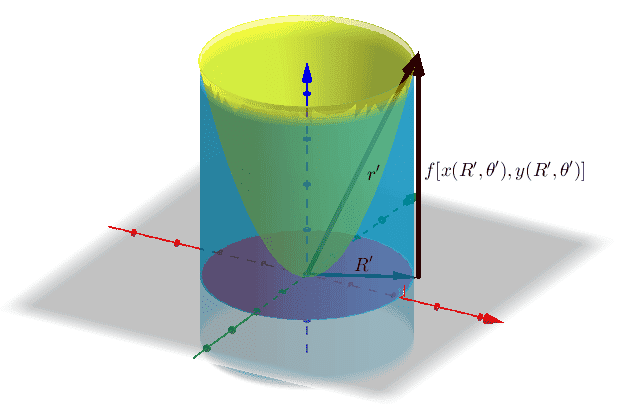

I had earlier looked into this problem from a different point of view. I needed to compute the integral at a point ##P∈S′##.
##\displaystyle k \oint_{S'} (\vec{M'}.\hat{n}) \nabla \left( \dfrac{1}{r} \right) dS'
=-k \oint_{S'} (\vec{M'}.\hat{n}) \dfrac{\hat{r}}{r^2} dS'##
I took the origin of my Cartesian coordinate system at ##P## and took the ##x##-##y## plane as the plane which is tangent to the surface ##S′## at point ##P##. Then I divided my domain into two parts: One containing the surface ##S′_1## whose projection in ##x-y## plane is a circle ##A## around point ##P##. The other the rest of the surface ##S′_2##.
As there are no singular points in ##S′_2##, its contribution to the surface integral is finite.
241776
As for ##S′_1## which contains a singular point at origin ##P##, I changed my domain from ##S′_1## to ##A##. In doing so, I had to introduce the function ##z=f(x,y)## which is a function dependent on the shape of ##S′_1##. Thus ##dS′## was replaced with ##\sqrt{f_x^2+f_y^2+1} dA′=\sqrt{f_x^2+f_y^2+1} R′ dR′ dθ'## where ##f_x## and ##f_y## are partial derivatives of ##f(x,y)## w.r.t. ##x## and ##y## respectively.
Also, I replaced ##r'## with ##\sqrt{R^2+f^2}##
I now understand why field is finite at the surface. However I still do not understand why this approach fails to converge.
