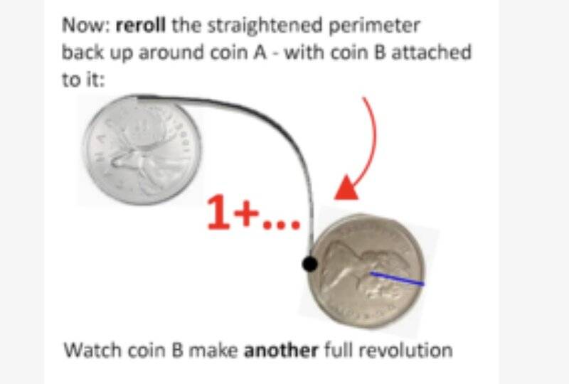

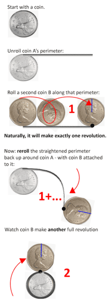

Have you watched the video?
Think this way… take the “unwound” circumference, then fold it in half. Have the coin roll along the top, then underneath along the bottom to the starting point. The coin traveled a certain distance. Now put your finger in the middle of the folded circumference and restore it to a circle. Wouldn’t the path now followed by the coin be longer?

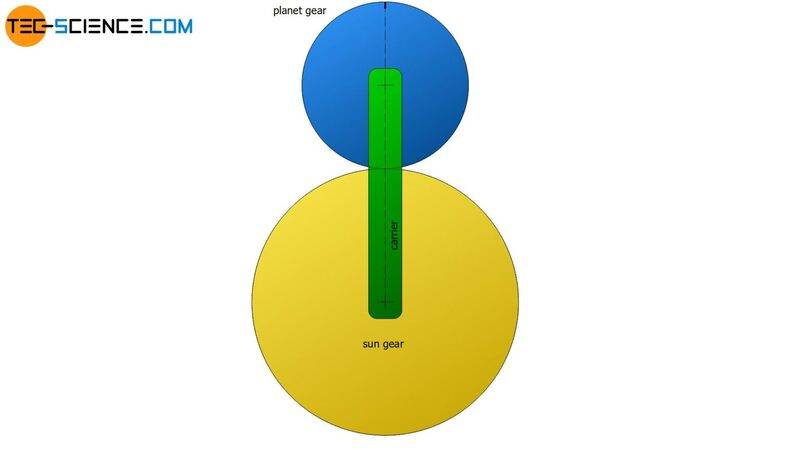

While I understand the '+1' rotation, I also consider the perspective from the rotating disk to be a legitimate answer. If you were sitting in a chair on the rotating disk, rolling around a disk of the same size, focusing only on the two discs, it would only take 1 rotation to complete 1 orbit. It's only when you take notice of the stationary universe around you that you see that you actually made two revolutions.
It's a legitmate answer in the same way that the Earth has 365 days per year relative to the Sun, but 366 rotations on its axis (sidereal days) per year relative to the background stars. What you describe is a direct analogy to this.
When you do the experiment, which is a critical thing to do, you clearly have to rotate the outer coin twice round the inner coin. To ignore that seems unenlightening, to say the least. Especially if you were to insist that it only rotates once, when an experiment clearly shows two rotations.
Likes Meru369, DaveC426913 and russ_watters

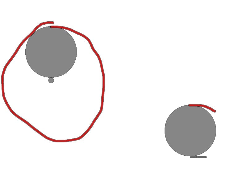

Sorry for the crude drawing but this is my argument for why the moving coin traveling in a circle "goes further."
On the bottom right, the 1/10th size coin's circumference is unwrapped and straightened. If we follow the top most point on the "moving coin" it only forms a small arc to roll the entire circumference of the smaller coin.
On the left, if we follow the same path of the top most point of the moving coin, it takes a much *longer* path as it must go all the way around the other coin on the circular path.
  • Sad
  • Skeptical
Likes PeroK and Motore
  • #32
Yes. So what?
  • #33
Ibix said:
Yes. So what?
It just makes more intuitive sense to my mind where the extra rotation comes from if we can also say the curved path followed by the coin is longer than the “unwound” straight path.

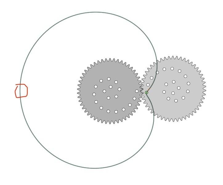

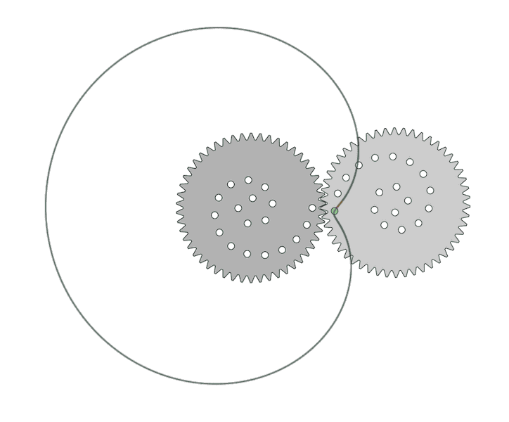

Interestingly in the 2 US quarters case if we compare the area "swept" by the full width of the moving coin between the case where the coin rolls around another identical coin or the coin rolls along a straight line equal in length to the coin's circumference, that swept area is as far as I can tell precisely double for the coin around another coin path, versus the straight path.
  • #36

  • #44
Ibix said:
That's the point I was trying to make in #30. The Lego gears is a good demo idea.
But that was my argument. The lego/spirograph gear shows that the outer ring (in the 1:1 size scenario) only went around the inner circle once.
source: https://nathanfriend.io/inspiral-web/

  • #46
When the “spirograph pen” reaches the point circled in red, the moving gear has completed 1 full rotation, and is only half way around the other gear…
  • #47
Yes, I'm quite aware of that fact.
  • #48
DaveC426913 said:
It has nothing to do with travelling "further".
Have you watched it? At 9:45 it explains that the distance the circle center travels determines the number of rotations the circle makes:
  • #49
Circle centre is another matter.
My demonstration (in post 6) - and my dialogue - is not addressing circle centre, but perimeter*.
There are several ways to "solve" the apparent paradox. My demonstration disambiguates the issue of trying to tracking distance (of perimeter), which seemed to be confusing Devin-M.
So, while you are not technically wrong in your reference to 9:45 of the video, it is out of context of my solution, and therefore I'd say it constitutes a red herring.
