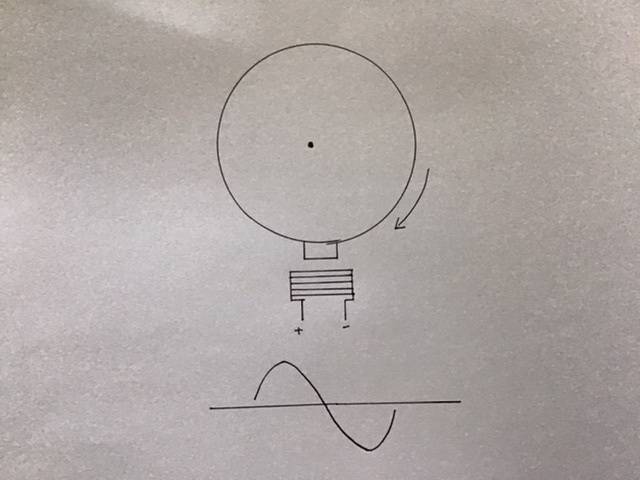

Here I have a rotating magnet attached to a disk and a power coil that turn on and off to provide power to turn the disk. The voltage waveform as the magnet pass the coil is as shown. If I avoid turning power on at peek voltage and turning power on at low voltage (at center of the wave form). Can I have unlimited speed increased in theory?
My understanding is that the main limit to motor speed is the structural integrity of the motor itself. Vibrations and structural failure from the centripetal acceleration are what limit the speed
I read that the factor that limit motor speed is back EMF. I might have to go to an electrician for this one.

As I drew in the voltage waveform, when the magnet change direction from incoming to outgoing, the back EMF is so small that we can inject current into the coil. Of course the wave form get bigger as speed increase, so we have to shorten the ON time of the coil. But we can always inject current no matter how fast the magnet go.

The coil is an inductor and it will become increasingly difficult to change the current through it as the frequency of your 'injections' increases. You will eventually choke the current down to negligible levels, preventing any further increase in the speed of the magnet.

Yes, I guess we have to assume the coil can be on instantly without being choke. What I'm trying to say is can we attain EMF greater than the supply voltage.

Well, my main purpose is to see if we can attain an EMF greater than the supply voltage. When the magnet pass by the coil, let's say it's supper fast that exceed the supply voltage, we aren't apply voltage to the coil because if we do, the magnet slow down in transfering energy to the supply. So we wait until the magnet about to reverse direction to turn on the coil because at that instant, the magnet induce very low EMF and the supply voltage can overcome that. Picking the right time to turn on the coil would further increase magnet speed. Of course when the coil is OFF, no current flow.

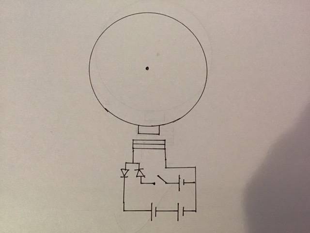

Tell me if this circuit possible. The switch close and open to spin the magnet. The magnet attain enough speed to charge two batteries in series.

To me it looks like a battery-powered motor-based heater.

Again, not an expert, but I don't think two dead batteries are supposed to be in parallel with the source and the input circuit of the generator. The current is going to flow out of the source and straight into the batteries until they are the same voltage as the source. The magnet here is pointless. It will just spin up until it reaches its maximum no-load speed and has little influence on the circuit. It certainly won't charge anything, as this is the input side of your generator, not the output.

OK, it's not great for a bunch of reasons, but I get what you're trying to do. The motor is completely irrelevant, or at least not optimal, for generating high voltages. Maybe in 1910, not in 2010.
Now days, this would be done with a switching power supply in a boost or flyback configuration. In essence, everything you think the motor is providing can be done with a simple inductor, which will be smaller, cheaper, more reliable, easier to design with, and will work better.
Next step: google "boost converter" or "flyback converter".

Base on the replies I think the answer is yes. Let's assume that everything is ideal. The current going into the magnet - current induced by magnet = 0 for steady state. Let's assume all batteries are 12Vs.
So from the input we have IV = current of 12V x 12V = Power input
From the output (charging) we have IV = same current x 24V = Power output

I don't know why you think this. I mean, it's possible to construct such a circuit. The question is whether it's useful or not. If you're trying to charge the batteries using your generator, then no, your circuit makes no sense. You're just building a generator that has no load on it, and thus will just freely spin while the voltage source charges the batteries a bit every time the switch is closed.

What output? That entire circuit is the input to the generator. You have no output.
The current input has to be equal to current output have steady state speed. If there is only input current, the wheel would keep speeding up. And when we draw output current, that is a load. Charging battery is a load.
That load is not on the generator, it is on the power source. The total current through the power source is the sum of the current through the bottom branch (two batteries) plus the generator input. The first of those never changes assuming ideal components (they are just resistive devices that dissipate energy). The bottom branch doesn't care about the top branch. You could cut the wires to the generator and nothing would happen to the bottom branch.
Trace the current through each branch. You'll notice that the current through the bottom branch never goes through the top and vice versa. The only thing changing in your circuit is the voltage across the top branch and its associated current as the generator gets up to speed. At first the voltage is 12 V and the current is maxed out (let's assume a small amount of resistance so we don't have infinite current). As the generator spins up the back EMF increases, which could be represented by a voltage source placed in series with the top branch and in opposition to the source voltage. This reduces the voltage across the top branch, which reduces the current. The back EMF increases as the generator spins up until the back EMF is equal to the source voltage and a steady state is reached. Since 'ideal' components would mean an infinite spin rate, let's assume a small amount of resistance. At this point the voltage across the top is very small since the back EMF is almost equal to the source voltage.
But nothing has happened to the bottom. It always has the source voltage, 12V in this case, across it regardless of what the generator is doing.

Hm... you might have read the diode wrong. The bottom 24V has diode that only allow current for charging direction . The bottom 24V cannot be the supply. When the switch close, current is draw from the 12V through the coil, speeding up the wheel. Then the switch open, it'll close again on the next turn. Notice the 12V cannot be charge because the diode only allow current out.

First, for clarity you are calling the current through the one battery the input and the current through the two batteries the output, right?
If so then what you say is wrong. Steady state current thorough the motor is not zero, and as long as the motor current is not zero then the input and output currents will not be equal.
