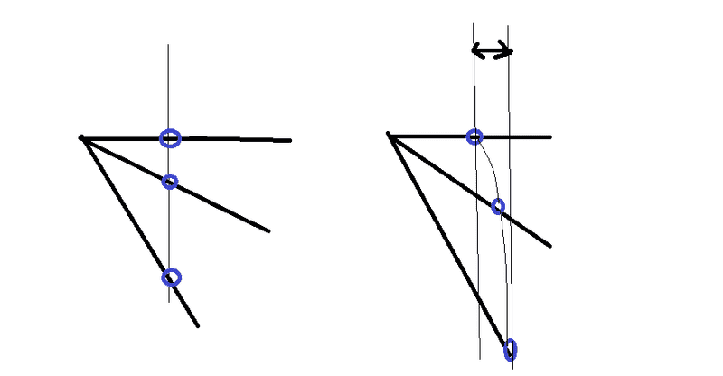

glass is sliding along door shelf, from inner part toward outward part if you open door too fast..

Outward force in inertial frame?

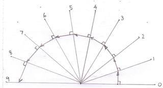

kuruman said:
your glass has zero right movement(left case), that is not correct
right case is correct.
Yes.

Consider the closed door starting to open. This gives a force perpendicular to the door, which starts putting the glass into motion downwards in your picture. At the insrant of opening downwards will be tangential and not radial. The glass will continue the induced downward motion unless acted upon by another force. However, as the door swings open by even a minor angle. This means that downwards is no longer purely tangential, it has a radial component. Hence, the glass now has a radial component of velocity without ever being acted upon by a radial force.

  • #31
Orodruin said:
No, it isn’t. For several reasons. Nor is the left picture except in very particular cases.Consider the closed door starting to open. This gives a force perpendicular to the door, which starts putting the glass into motion downwards in your picture. At the insrant of opening downwards will be tangential and not radial. The glass will continue the induced downward motion unless acted upon by another force. However, as the door swings open by even a minor angle. This means that downwards is no longer purely tangential, it has a radial component. Hence, the glass now has a radial component of velocity without ever being acted upon by a radial force.
Why right case is not correct and is left case possible in reality?
  • #32
You drew that image using the inertial reference frame where centrifugal force is zero. So the bottle cannot move to the right; there are no forces in that direction. Thus the right hand diagram is wrong.
The left hand diagram is possible if there is zero friction between the door tray and the bottle and the door tray is very wide. The bottle gets an initial downward impulse from the door and then skates frictionlessly downwards.
In practice that's not possible, and the bottle path will curve slightly to the left due to friction and bumping into the door.

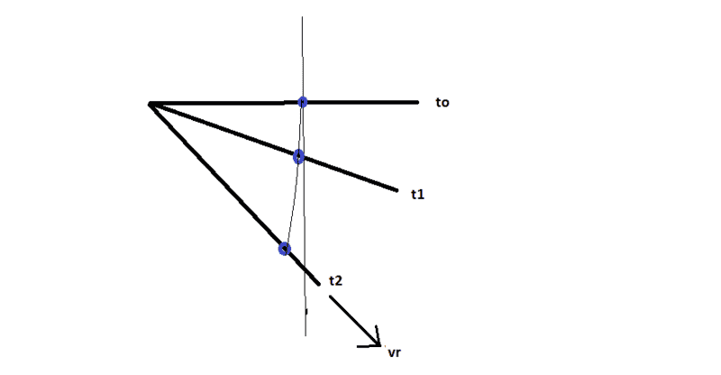

Bottle will curve to the left like this, so acceleration is inward?
1.If I stop door rotation in time t2 and if door end is open, then bottle will leave door in radial direction vr?
2.If bottle leave door(open end) when door is still rotating, it will leave door with tangential direction?
Likes Dale
  • #35
The acceleration is to the left. I wouldn't characterise it as radial.
It'll bump into the door or the railing of the shelf it's on and bounce off, or it may already be sliding along the railing. The result of the force from the railing will be to push the bottle outwards, yes.
Depends on a lot of details of the experiment. In the idealised case shown in your original left hand diagram, no it'll go straight down. If the bottle is small compared to the width of the door and it's sliding along the door rather than skating along frictionlessly, then it'll be tangential, yes.
