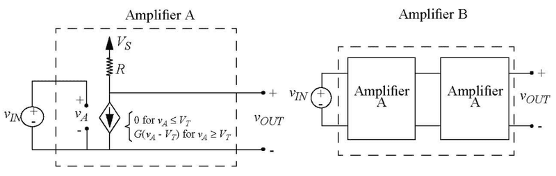

Consider the following two amplifiers
We are asked to show that the dependent current source sinks power for ##v_{\text{out}}>0## and sources power for ##v_{\text{out}}<0##. I don't know how to do this.
There are a few questions before this one about the amplifers. In what follows, let me go through the calculations that they entailed.
Amplifier A is a single-state amplifier implemented with a voltage-dependent current source and pull-up resistor.
Let's assume that the current source parameters ##G## and ##V_T## satisfy ##G>0## and ##V_S>V_T>0##. In addition, assume that ##RG<\frac{V_S}{V_S-V_T}##.
Amplifier B is a two-stage amplifier in which each stage is identical to amplifier A.

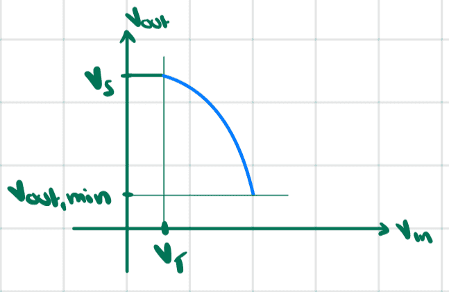

Graphically, this relationship looks like the light blue curve below
As ##v_{\text{in}}## increases, ##v_{\text{out}}## decreases until we have ##v_{\text{out, min}}=v_{\text{in}}-V_T##.
$$v_{\text{out,min}}=V_S-RGv^2_{\text{out,min}}\tag{3}$$
which gives
$$v_{\text{out,min}}=\frac{-1+\sqrt{1+4RGV_S}}{2RG}\tag{4}$$

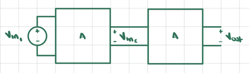

I'd like to determine ##v_{\text{out}}## as function of ##v_{\text{in}}## for amplifier B.
It seems that we have the following setup
Assuming ##v_{\text{in,1}}\geq V_T## then
$$v_{\text{in,2}}=V_S-RG(v_{\text{in,1}}-V_T)^2\tag{5}$$
and assuming ##v_{\text{in,2}}\geq V_T## then
$$v_{\text{out}}=V_S-RG(v_{\text{in,2}}-V_T)^2\tag{6}$$
Subbing (5) into (6) we get
$$v_{\text{out}}=V_S-RG(V_S-V_T-RG(v_{\text{in,1}}-V_T)^2)^2\tag{7}$$
$$=(V_S-RG(V_S-V_T)^2)-2(RG)^2(V_S-V_T)(v_{\text{in,1}}-V_T)^2-(RG)^3(v_{\text{in,1}}-V_T)^4\tag{8}$$
This is the relationship between ##v_{\text{out}}## and ##v_{\text{in}}## for amplifier B.

Consider amplifier A again. Show that the dependent current source sinks power for ##v_{\text{out}}>0## and sources power for ##v_{\text{out}}<0##.
If ##v_{\text{out}}## is negative does this mean the voltage source is such that the positive terminal is now on the bottom and ##v_{\text{in}}>V_S##?
