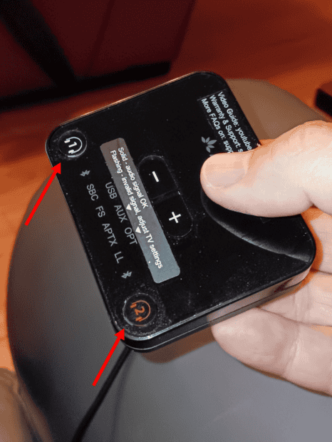

So, my nightly ritual when wanting to watch TV is as follows (Note that this process must be repeated for EACH set):
  1. Turn on the headset. It says hello and then makes a sad noise, telling me it isn't paired.
  2. Press the little PAIR button (which is integrated into the On/Off button) (see pic 1).
  3. Wait.
  4. It does not pair.
  5. Press the OTHER pair button. (between the + and - volume) (see pic 1).
  6. Wait.
  7. It does not pair.
  8. Go up to the TV, see that the little box has no Bluetooth lights on. Press them. (see pic 2)
  9. Wait.
  10. Remember I have to hold the button.
  11. Press and hold the button until it flashes.
  12. Turn headset off and back on.
  13. Press the PAIR button.
  14. Sigh and press the OTHER PAIR button.
  15. By now, three minutes has gone by and my blood pressue is in triple digits, but ...
  16. My TV show is blasting away .... on the other TV in the room upstairs.
  17. Tear the whole thing out and throw away in disgust.

Understand the difference between PAIRING and CONNECTING.
So here is how that ritual looks from the POV of the headset and the transmitter plugged in to the TV:
YouThe headsetThe headset transmitter
1. Turn on the headset.Yippee! Somebody wants to use me, I'll say hello.[asleep]
It says helloI'd better connect to my transmitter. Oh no, I can't find my transmitter, I'll make a sad noise to tell my owner I can't connect.
and then makes a sad noise, telling me it isn't paired [this is wrong of course].[waiting][asleep]
Oh, my owner wants me to pair with a new transmitter, I wonder why, I was quite happy with the existing one. Anyway I must do what I'm told so I'll stop trying to connect to the existing transmitter and look for a new one that wants to pair with me.[asleep]
3. Wait.I've been looking for a new transmitter for ages but I haven't found one so I'll give up.[still asleep]
4. It does not pair.[waiting for instruction][asleep]
5. Press the OTHER pair button. (between the + and - volume) (see pic 1).Oh, my owner has now pressed my CONNECT button, he doesn't want me to pair with a new transmitter after all so I'll try again to connect to the existing one.[asleep]
6. Wait.[still trying to connect][still asleep]
7. It does not pair.[still trying to connect][still asleep]
8. Go up to the TV, see that the little box has no Bluetooth lights on. Press them. (see pic 2)[still trying to connect][still asleep]
9. Wait.[still trying to connect][still asleep]
10. Remember I have to hold the button.I haven't found my friend the transmitter, I'd better stop looking to save my battery for when my owner really wants me (searching for and establishing a connection takes much more power than maintaining it)[still asleep]
11. Press and hold the button until it flashes.[asleep]Yippee! Somebody has woken me up, I'll try to connect to my friend the headset.
12. Turn headset off and back on.[waking up][still trying to connect]
13. Press the PAIR button.Oh, my owner wants me to pair with a new transmitter, I wonder why, I was quite happy with the existing one. Anyway I must do what I'm told so I'll stop getting ready to connect to the existing transmitter and look for a new one that wants to pair with me.[still trying to connect]
14. Sigh and press the OTHER PAIR button.Oh, my owner has now pressed my CONNECT button, he doesn't want me to pair with a new transmitter after all so I'll try to connect to the existing one.[still trying to connect]
15. By now, three minutes has gone by and my blood pressue is in triple digits, but ...Yayy, here's my friend the transmitter, we can get connected!Yayy, here's my friend the headset, we can get connected!
16. My TV show is blasting away .... on the other TV in the room upstairs.[still connected][still connected]
17. Tear the whole thing out and throw away in disgust.Oh, no we've made our owner unhappy but we only did what we were told. I'm sorry, please don't kill me, just give me another cha...Oh, no we've made our owner unhappy but we only did what we were told. I'm sorry, please don't kill me, just give me another cha...
And here's how it should go.
1. Go up to the TV, see that the little box has no Bluetooth lights on. Do whatever the manual says you need to to wake it up.[asleep]Yippee! Somebody has woken me up, I'll try to connect to my friends the headsets.
2. Turn on the headsets.Yippee! Somebody wants to use me, I'll say hello and try and connect to my friend the transmitter. Yayy, here they are, we can get connected!Yayy, here's my friend the headset, we can get connected!

OK, the tears and heartache have returned. Revisiting this one last time before I bin this $160 investement and try again.
I don't know why, but one headset seems to have the problem way more than the other. My wife's set never seems to get forgotten. It's always mine. But, frankly, I am more likely to put that down to the order in which they get processed. i.e. my set goes first and soaks up all the trouble, leaving hers, second, a clear connection.
Here's one of the things that leads me to suspect this:
The reason mine can't seem to connect has a lot to do with the apparent affinity that the transmitter has for a bluetooth speaker elsewhere in the house (about ten yards away through at least one wall). Whenever the transmitter is set to try to connect, it will, more often than not, connect to that speaker on the other side of the house over the head set on the angry doofus right next to it. (Whoch makes for some alarming cursing from my son who is trying to watch TV.)
What I don't understand is how this transmitter knows what to connect to. As my son points out, BT devices that connect to my computer or phone have an interface where I can tell them what to connect to and what not to connect to. How does that work for this tiny box that has no such interface?
I have engaged a chat agent who has given me a procedure that should "lock" the connnection. Apparently, there are various "flavours" of connectedness; some are one-off, some are permanent.
  1. Please turn the 2 headphones off.
  2. Long the + and the - buttons on the transmitter until buttons 1 and 2 turn solid PINK. Then unplug the USB power cable from the transmitter, do not just turn it off, you need to unplug the cord. Ten seconds later, plug the cable back into the transmitter and turn the transmitter on. Press button 1 to get it into pairing mode, should flash red and blue.
  3. On the black headphones, turn it on, slide the switch to the Bluetooth/PAIR position, and wait until the headphones flash red and blue then let go of the button.
  4. Once the transmitter and the black headphones are connected, press button 1 on the transmitter for 10 seconds, until you find the Bluetooth close to button 1 flashes RED and BLUE at the same time ( looks like PINK) for 5 seconds. Now, they are locked.
  5. On the red headphones, turn it on, slide the switch to the Bluetooth/PAIR position, and wait until the headphones flash red and blue then let go of the button. Then hold down button 2 on the transmitter and release it when it flashes red and blue. Wait until both the transmitter and the red headphones turn to solid blue.
