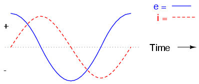

Why does current lag behind voltage in inductor?
In summary, the conversation discusses the concept of inductors and their role in circuits. Inductors are named for their high magnetic coupling, which causes their magnetic field to affect the element itself. They react against changes in current, causing a lag between voltage and current. This is due to the induction of an electric field that counteracts the change in magnetic field. The conversation also touches on the concepts of reactive resistance and power in AC circuits.
Bassalisk
947
I've seen that this question has been asked but never answered because guy was silent on formulas.
I can say that i am familiar with formulas, and i know how to derive the equation for current, and that II/2 lag, but here is the thing... Why? i know that formulas say so... But can someone please try to explain this to me in more touchable and intuitive way ?
Thanks
Inductors react against a change in current. Applying a voltage to its terminals will produce a current that will then create a magnetic field like any other wire. An inductor is called as such because its magnetic coupling is high. In other words, the magnetic field it creates will have an effect on the element itself.
If the magnectic field varies with time (which is the case when you just applied a voltage to the inductor terminals), an electric field will be induced within the wire the counter the change in magnetic field. This E-field will tend to "stop" the current that would normally be present without the inductance effect. Thus current "lags" behind voltage. Too quick of change in current creates an e-field that decreases dI/dt.
You can see an inductor like a wheel that is free to spin due to the flow of a river. If the flow changes too quickly, the wheel, due to its inertia, will tend to keep spinning for a moment. The same is true if the water of the river goes from steady to flowing in a short instant.
http://en.wikipedia.org/wiki/Lenz%27s_law"
"An induced current is always in such a direction as to oppose the motion or change causing it"
So you apply your voltage to an inductor and the coil shape acts to oppose the change in current. Note that the voltage that changes the current comes first, and then the induced current (and flux) change. Also note that 90 degrees out of phase only works for ideal inductors.
Another way of looking at it is that if you apply your source voltage to an inductor, V(S) = sin(wt) then the current must be i = sin(wt)/R, so by the inductor formula:
V(L) = L di/dt = L/R d sin(wt)/dt = L/R cos(wt)
And we know that cos(wt) is 90 degrees ahead of sin(wt).
So basically, we apply AC to a inductor, and then current "pushes" more and more through conductor, it induces more and more induced current? and that induced current is in some way pushing back the current that was originally going through inductor?
But the voltage on the inductor stays the same?

Hi Bassalisk! :smile:
In a resistor, voltage and current are dependent on each other, but in an inductor they are independent (so there is no resistance), and instead voltage is dependent on the rate of change of current: V = LdI/dt.
In a steady AC circuit, however, the rate of change of current is conveniently proportional to the current itself (and to the frequency), but 90° out of phase.
So the voltage is also 90° out of phase with the current. :wink:

In an inductor, V is proportional to dI/dt, so (in a steady AC circuit) V leads I by 90°.
In a https://www.physicsforums.com/library.php?do=view_item&itemid=112", I is proportional to dV/dt, so (in a steady AC circuit) I leads V by 90°. :wink:
