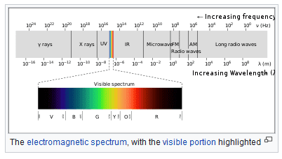

Welcome to PF. :smile:
The naming of some of the colors is for human convenience; there is actually a continuum of frequencies in the visible spectrum, as with the rest of the EM spectrum:
https://en.wikipedia.org/wiki/Light

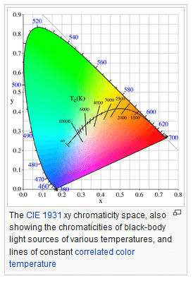

Dangit I see seven colors in the CIE chart too...

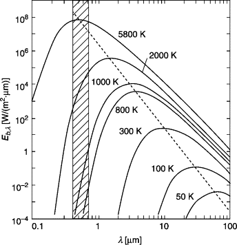

hilbert2 said:
That way you could see in the dark and locate people by "seeing" how their body temperature is higher than ambient.
hilbert2 said:
Here's one news article about that, but it's about research conducted by the Chinese:
https://www.slashgear.com/night-vision-eyedrops-nanoparticles-research-infrared-vision-28567893/
I think the distinction between "night vision" (which is Near Infrared (NIR) often actively illuminated usually silicon detected devices) and thermal imaging FIR devices needs to be emphasized here. Only the thermal imaging devices will see the glowing enemy combatant in the dark field but these are very different from usual silicon optics or eyeballs.
I once had to explain this to a client who had already spent a fair sum of money trying to develop a silicon CCD-based imaging thermometer. Lack of understanding can be expensive, and I felt like the Grinch as I invoiced him for my services.
A good point. You'd have to detect wave lengths over 1 micrometer to have temperature differences near room temperature be visible, and the chemical properties of surfaces would also affect the appearance at the same time.
