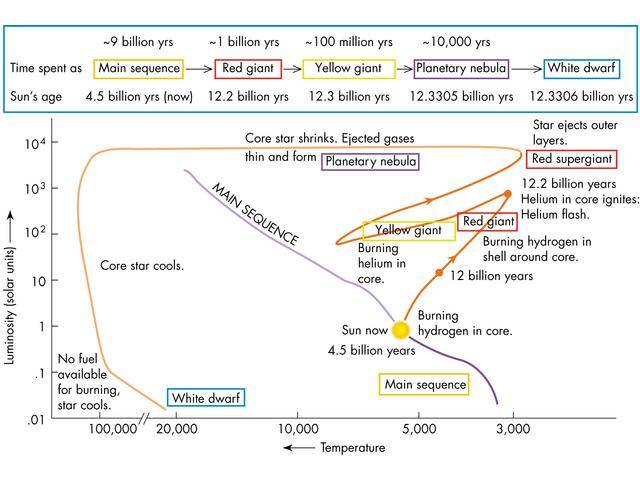

I will need to talk to students about the evolution of a solar-like star. We will look at a diagram like the following:
It will be a descriptive presentation, no mathematics. I know pretty well what happens until the formation of the carbon core. The linear upper line happens because the outer shells will be ejected and gradually the core will become visible so of course the temperature strongly increases (what we effectively see is the core). But why this increase in temperature is at constant luminosity, and why do we have that abrupt decrease in luminosity just before the white dwarf stage?

OK, let me see if I got it correctly.
On the upper line, the burning He shell is still there, the star gets hotter as the shell gets closer to the surface as material continues to be ejected.
On the left corner point, the fusion in the shell ceases, causing an abrupt fall in luminosity. Without the fusion, the remaining material falls back and concentration increases until degeneracy sets in everywhere. And then it cools.

Precisely. The luminosity during the planetary nebula phase remains relatively unchanged because the temperature continues to increase even as the size of the star decreases. But once the inner helium layer is consumed and the star has compressed to its smallest point, the luminosity will diminish as the white dwarf cools. That cooling process (from the upper left to the lower left) can take 14 billion years or more.
Also a point to add-- the reason the luminosity stays constant while the helium shell is burning is that its luminosity is set by the attributes of the core, not the envelope. The envelope is fully convective, and convection is very efficient at accomodating pretty much any luminosity you hand it, even if it is getting peeled away into space so that the stellar surface is getting smaller. As pointed out above, the precipitous drop in luminosity is when the fusion runs out, and the final cooling phase is a white dwarf of constant size, because by then the amount of heat the star will lose is a tiny fraction of the vast internal kinetic energy already in there, hence requiring essentially no adjustment in its structure as it cools. That's why the final cooling phase should follow a contour of constant surface area.

So, at the upper right point, where the horizontal line starts, the carbon core should have ended its shrinking? If not, any further shrinking of the nucleus would have influenced the luminosity of the shell and the line would no longer be horizontal?
Yes, exactly. But note that the timescale for the star to cross the H-R diagram is quite short, there's not much evolution of the core going on there, it's more just the timescale to peel off the envelope once the envelope is inclined to be so peeled. The key point is the nature of the envelope doesn't feed back onto the core properties, the luminosity is set in a very inside-out fashion there-- until the absence of an envelope alters the properties of the burning and shuts it off altogether. I think it must be that the helium itself is eventually peeled off, more so than burnt up, causing the precipitous drop in luminosity.
