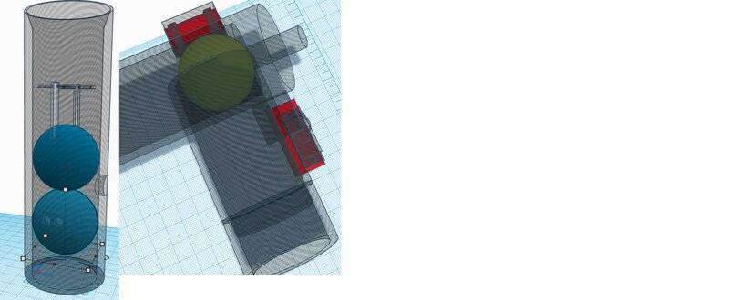

Hi,
We have tried to create various models of a "pingpong ball launcher" that works on a burst of air from a standard compressor.
Each version we tried to build results in the pingpong ball spinning inside the tube instead of launching out of the tube (bernoulli ?)
We varied the air pressure, pipe diameter, loading mechanism shape and direction of the air.
How can we launch a pingpong ball correctly using a burst of air without losing too much energy and without the ball spinning in place ?
tnx,
Pete

A friction fit with a pressure treshold unfortunately does not have our preference as there is a (very) slight difference in ball diameters and surface roughness with different colors. Also the construction becomes more complex (and more importantly prone to wear/tear or failure).
While we can sometimes launch (40mm diameter) balls out of a (40.5 mm diam.) tube with great force when we simply push a compressor hose into the tube the exact physics elude us as this is only works 20-30% of the time. At other times the ball just sits there spinning inside the tube.
We were hoping to find some solution in directing airflow a certain way, or disturbing air patterns so the spinning can never take place.

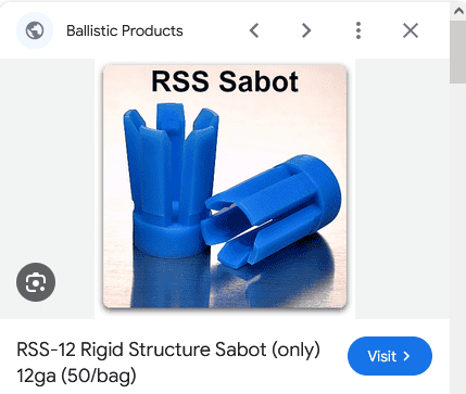

Have you considered using some sort of sabot to give you a reliable "pusher" piece that separates from the ping pong ball once out of the barrel? You could make some cylindrical sabot things that fit well inside the barrel to give a good consistent seal, and place the ping pong ball on top of the sabot to be launched with the blast of compressed air.

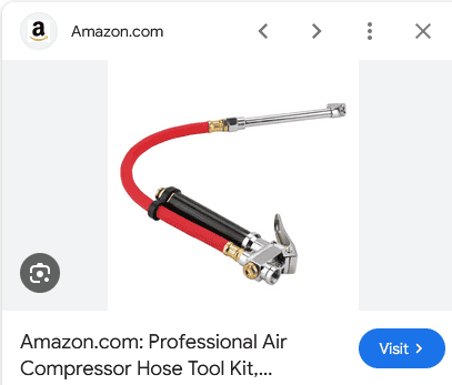

I would use something like this type of trigger for the compressed air, like you see at vehicle gas/service stations for filling tires:
And I might try making the initial sabot pieces out of some plastic things that are the correct diameter to fit in your barrel:
