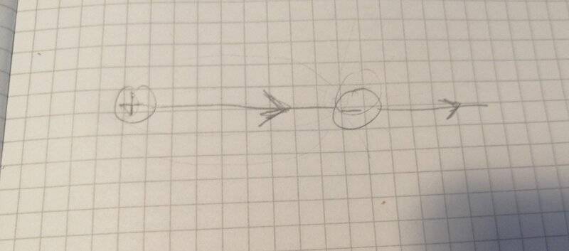

I wonder how is possible that positive charge can exert el. field beyond negative charge?
E=(k*Q)/r^2
I wonder how it is possible that a positive charge can exert el. field beyond negative charge?
Shouldn't they "connect" and therefore positive charge should stop to have el. field beyond neg. charge? I mean, I am obviously wrong about that, but can someone please explain why/how el. field from positive charge continues beyond negative charge?

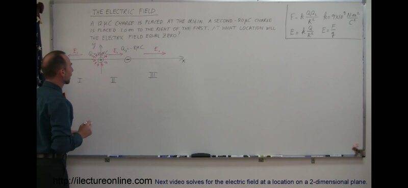

Red arrows represent the direction of el. field of positive charge(pic below). Also here is the link to YT video( ).
In this case, they are of different value, but would positive charge exert el. field beyond negative charge if they were of same value?
Thank you

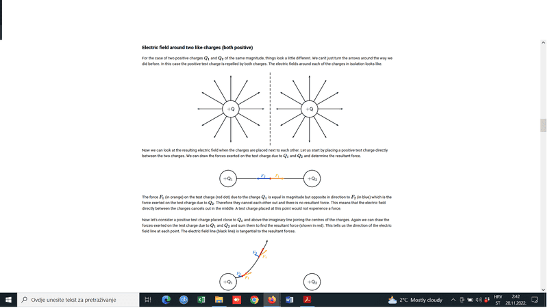

The fields simply add up (as vectors). If the charges have the same but opposite value, the field strength from the charge that is further away can't outdo the field from the closer one.
Draw plots of the horizontal component of ##\vec E## on the horizontal axis to convince yourself.
So, that means that field from the positive charge continues to go through the negative charge?
Like this(pic below)?

And I forgot to ask, what is meant when they say that el. fields cancel each other out? I don't get that. If you open the link of the video I posted in the opening post and go to the end of the video, you will hear that guy from the video(I guess his name is Michael Van Biezen) says that at 5.45 meters on the x-axis charges cancel out and that el. field is 0 at that point. How can el. field be 0 if el. field has no end? It can only become weaker and weaker with distance but can't disappear.
EDIT: I understand what is meant when it's said that same charges cancel out right in the middle(so that there is no el. field at that one point), but how can opposite charges cancel out?

The two electrostatic forces cancel at that point only. The x component of the field changes sign at that point, that's all. On one side the nearest charge wins, on the other side the stronger charge wins.
