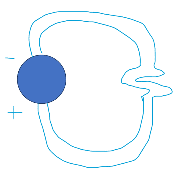

Here comes an awful drawing to explain the concept.
Imagine the only losses in the pipes come from those close bends at the right (resistance shape). Let's keep the section of the pipes constant at all times for simplicity and because changing it adds no value to the point.
A first key point, the fluid is incompressible so mass continuity causes the speed of the fluid to be constant in the whole system. If it were faster before the resistance and slower after it, at some point it'd need to bunch up and that's not allowed because of the incompressibility thing.
Now, the pressure difference in that ideal pump will be the same no matter what. Since the system is stationary (doesn't change with time), the energy input by the pump must be the same as the consumed in the bends. Therefore, the pressure drop in the bendy pipes is the same as the pressure jump in the pump.
Finally, the pressure drop in the bendy pipes is dependent on the velocity of the fluid. So the greater resistance / bendier pipes will cause an equilibrium point where the flow is running slower / lower intensity.

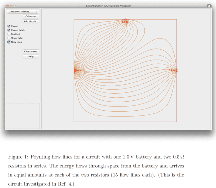

One should note that the correct understanding of energy transport through electromagnetic interactions originates from the 2nd half of the 19th century, strongly triggered by electrical engineers, who adopted quite quickly Maxwell's theoretical work. These "Maxwellians" were tremendously successful. Most prominently one should mention Heaviside, who brought Maxwell's theory in the form we know today, i.e., in the formulation with fields, using (3D Euclidean) vectors rather then quaternions.
The question about energy transport became particularly interesting to the engineers, who tried to build sea cables for telegraphing, which of course is a tremendous problem given that you deal with sea water etc. From thinking about these problems, Poynting came to his concept of energy transport by analyzing the energy-conservation law for electromagnetic fields and charged matter.
bmhiggs said:
If that is not the case, what is the mechanism for the energy transfer in a circuit - say a basic filament lightbulb? The electric field does the work on the charge, but how does that get transformed into light and heat? I'm looking for a solid conceptual understanding here.
The most simple example, which you can pretty easily calculate analytically is the very long coaxial cable for a constant (DC) current. You'll find that the energy transport from the "battery" at one end and a "resistor" at the other end is due to the electromagnetic field rather than by the "electrons" making up the current.
Another argument is that if you use simple point-particle models a la Drude you'll find that the electrons' drift velocity is tiny for usual household currents, i.e., in the order of mm/s (millimeters per second). Now, if you think that the energy transport is through the electrons, this would imply that for the few meters from the source to a light bulb it would take some minutes to get light when switching it on, which is in clear contradiction to what's observed.
To make this argument quantitative you can use the "telegrapher's equation", which is an approximation to the full Maxwell equations for the coax cable (in terms of these full solutions you get the socalled TEM mode, which is sufficient to get the principle working described right). What you find then solving the time-dependent problem of switching on the DC circuit is that the time it takes to get the light on is given by the speed of the electromagnetic wave along the cable, which is in the order of the speed of light (in the dielectric between the inner and outer conductors making up the coax cable), which explains, why it doesn't take some minutes to get light when switching on the circuit.
