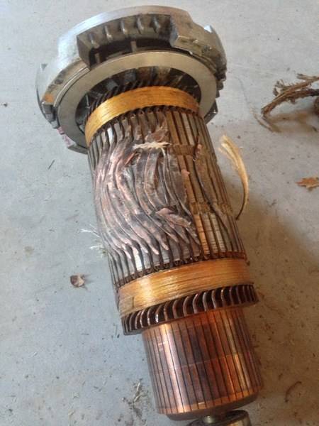

[QUOTE ]So if I reduce the flux to zero suddenly, field circuit trips, then would the rotor accelerate to dangerous speeds?[/QUOTE]
If you could reduce flux to zero there'd be no torque and no counter emf
so armature current would go to Vapplied/Rarmature , a very large number of amps.
In actuality you can only reduce field current to zero and you are left with residual flux of the field structure.
So RPM goes to a very large number unless load can hold it back.
An unloaded motor that loses field current will overspeed and wreck itself .. The armature wires get slung by centrifugal force out of their slots into the airgap and crushed against stator..
http://electricmr2ev.blogspot.com/2013/01/warp9-disaster-overspeed-motor.html

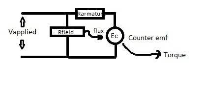

Let's assume nice round numbers for a starting point
Vapplied = 100VDC
Rarmature = 0.1 ohm
Rfield = 100
flux Φ = 1 weber per amp
torque = 7.04 ft lbs
We'll assume this motor is connected to some constant torque load like an elevator, so as to only change one variable at a time.
Ifield = Vapplied/Rfield = 100V/100Ω = 1 amp
so Φ = 1 weber
(Since this is a thought experiment i arbitrarily set K for this machine = 1, ordinarily you'd determine it from open circuit test on a dynamometer)
Since Torque = 7.04 K Φ Iarmature ,,, Iarmature must be 1 amp
Counter emf must be Vapplied - IarmatureRarmature = 99.9 volts
Since counter emf = K Φ RPM , RPM = (counter emf)/KΦ = 99.9RPM
Power = 2Π X torque X RPM/33000 = 0.134 hp
Now we'll halve field current
so Φ = 1/2 weber
Torque is still 7.04 ft-lbs , = 7.04 K Φ/2 Iarmature
so Iarmature doubles to 2 amps
Counter emf drops by increased voltage across Rarmature, now 2 amps X 0.1 ohm , to new value of 99.8 volts,
Counter emf = KΦRPM so RPM = 99.8 = RPM X 1/2 , RPM = 199.6
Power = 2Π X Torque X RPM = 0.276 hp, note it and RPM both nearly doubled.
In real life the load is probably not constant torque but something like a fan or vehicle where torque goes up with speed.
So it would settle at somewhat higher speed and somewhat higher torque.
It's counterintuitive until one works some problems.
If one halves voltage applied to both armature and field , same torque...
Ifield = Vapplied/Rfield = 50V/100Ω = 1 amp
so Φ = 1/2 weber
Since Torque = 7.04 K Φ Iarmature , Iarmature must be 2 amp
Counter emf must be Vapplied - IarmatureRarmature = 50 - 2X 0.1 = 49.8 voltsSince counter emf = K Φ RPM , RPM = (counter emf)/KΦ = 49.8/0.5 = 99.6 RPM

Armature current goes up because counter EMF went down, leaving more voltage available to push current through armature resistance.
It has to be said that you could build a motor that would slow down as the field was reduced. Such a motor would have a high armature (or supply) series resistance. Fact is that such motors are not made and they are not the sort of 'semi-ideal' motor (system) that we are discussing here. I think it is this sort of motor that our 'nay sayers' are sub-consciously considering in their minds.

It might help you to figure what would be speed of that hypothetical motor at zero torque (hint counter emf = applied voltage, armature current is zero)
and what would be its torque at zero speed( hint counter emf = zero, and we worked an example above )
and what would be its torque at halfway between zero and no load speed.
Plot them and you'd have a primitive speed-torque curve for the motor.
Then change Rarmature to one ohm and repeat.
Then change Rarmature to ten ohms and repeat.
That'd give you a feel for what Sophie is saying about motor characteristics dependent on armature resistance.
Realize that any load has a speed-torque curve also, and a system of motor&load will settle out where the two curves cross.
