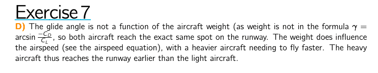

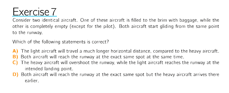

It's a homework question, but I feel like it fits better in this forum. The solution fails to convince me because C_D and C_L can be both written in terms of weight:
$$C_L=\frac{2W}{\rho v^2 S}$$
$$C_D=C_{D0}+k_1 C_L(W)+K_2 C_L(W)^2$$
Question:
Solution:

The thing is that lift and lift-induced-drag are two faces of the same coin.
Within certain limits of angles and speeds, useful lift can’t exist without the useless drag induced by the wings.
If more lift is needed to keep a heavier load flying at the same speed, proportionally more lift-induced-drag will result (increased angle of attack).
If speed is instead increased to achieve more lift, more parasitic drag will be induced (increased skin friction and shape drag).
A jumbo jet has a gliding ratio as good as a very light airplane.
Both have an optimal speed/AOA for which both drags reach a minimum value, resulting in more economic horizontal flight (less fuel is used for same covered distance).
