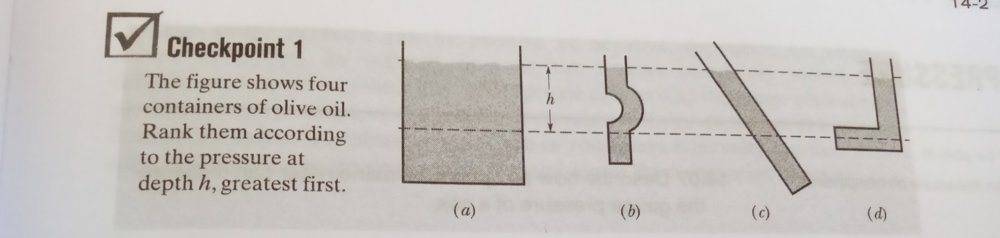

Why doesn't pressure depend on the shape of the container?
In summary, the pressure in the upward direction is generated by the water in the horizontal bit stopping the water in the vertical bit from flowing downwards into the horizontal bit.

As we know that liquids(same) at same height exert same pressure because of height difference but as I have a question in which there are some figures In which the (d) part lower part is extended horizontally,so by common sense the pressure in horizontal direction should increase But why at that level(horizontal) pressure increases from all sides?
Please try to tell me verbally not by proving it mathematically.

The pressure at a given depth is a function solely of the depth of the fluid. Extending the container horizontally has no effect on the pressure. In figure d, at every point on the lower dotted line the pressure is the same.
Hemant said:
..., so by common sense ...
You have to explain your reasoning, if you want people to help you to fix it.
The pressure spreads out throughout the liquid. The more liquid there is, the more force there is; but also, the more liquid there is, the more room there is for the force to spread out. So it always balances out no matter how much liquid you have.
Because it spreads out throughout, it doesn't matter what shape the container is.

The pressure in liquid is because of water coloum above the surface but there is no water coloum above a point in lower horizontal tube part in figure(d) on left hand side but why at any point in lower horizontal tube part has same pressure as that of other tubes.
Push the end of the tube in a little bit. What happens to the water level at the top of the tube?
If you stop pushing at the end of the tube, what happens to the end of the tube? What happens to the water level?
I understand the thing you want to say but I want to know from where the pressure in upward side will generated.
On the upward side of what? The horizontal bit of the tube? It comes from the water in the horizontal bit stopping the water in the vertical bit from flowing downwards into the horizontal bit.

I am talking about a point on lower horizontal portion of L tube in d figure which can lie anywhere on left hand side to the point where both the horizontal and vertical part of tube meets.
Like I said - the tube stops the water in the horizontal section from flowing away, which stops the water in the vertical section from flowing down. Hence the pressure.

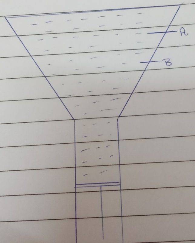

Can anyone also explain me this case,
If we create a pressure in liquid by pushing the piston in given figure a same pressure will be developed in height a and b a irrespective of their area please tell me why a same pressure propagates.
Hemant said:
WhyOk sir I will work on itCan anyone also explain me this case,
Post #15 is still an excellent answer. Changing the example doesn't change the basic principles. Can you explain what it is about post #15 you don't understand?
There is an important difference between the image of the four containers in post #1, and the image of the funnel shaped container in post #21. The containers shown in post #1 are all open at the top, so the weight of the air in the atmosphere above each container is pressing down on the top layer of the liquid in the container. The pressure at the top layer of the liquid is about 14.7 lb/in^2. At lower levels in each container, there is also the additional weight of the liquid above, so the pressure is higher at lower horizontal levels (i.e., for larger values of h). For container d, with a horizontal extension, it doesn't matter how far horizontally that extension goes -- all points at the same horizontal level have the same height of fluid and the same column of atmospheric air pressing on them, so the pressure is the same at each point that is h units below the top of the liquid.
The container in post #21 is different, because it is closed at the top, so the air in the atmosphere is not pressing down on the top layer of fluid. Let's say that you start the experiment by turning the container over and filling it with fluid, and then inserting the piston so that there is no air between the piston and fluid. Now turn the container again so that the piston is at the bottom. At this time, because of atmospheric pressure on the outer end of the piston, the pressure inside the container will be the same as atmospheric pressure, about 14.7 lb/in^2.
If you push on the piston, you're squeezing the molecules of liquid near the piston. These molecules in turn push against other molecules higher up until all of the fluid in the container reaches the same, higher pressure. When you apply a force on the piston, which has a certain cross-sectional area, you're increasing the pressure on the liquid in the container, and that pressure propagates to all points, and all levels of that container. In this case, because the container is closed, it's not possible for the pressure to be greater at some places than at others.

Sir I want to know that when a pressure wave is generated by Piston in fluid why their is no change in pressure wave as it propagates though fluid.
Pascal's principle has to do with hydrostatics -- no transient pressures, no accelerations, no fluid flows. Everything is static.
The words you use above, "pressure wave" apply to hydrodynamics. There are transient pressures, accelerations and flows.
Pressure waves can and do change over time and space as they propagate through a fluid. Static pressure, by definition, does not change over time and does not change along a horizontal line.
After the disturbance produced by a piston's sudden motion has died away and everything has settled into a new equilibrium, one can look at the pressure along a horizontal line and find that it is the same all along it. That has very little to do with the transient behavior while the system was settling into its new equilibrium and everything to do with the conditions required for the new equilibrium to exist.
