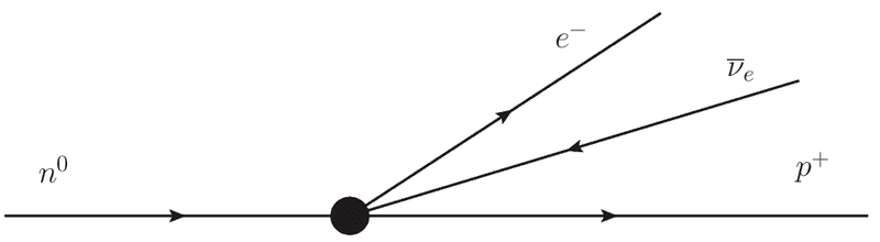

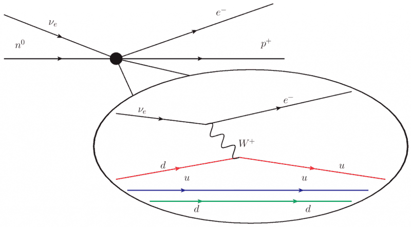

In summary, the Feynman diagram you'd naively draw for a beta decay such as p\rightarrow n + e^++\bar{\nu} would have four lines joined at a vertex, but in reality there's a virtual W or Z involved, which makes it into two 3-vertices.

The Feynman diagram you'd naively draw for a beta decay such as [itex]p\rightarrow n + e^++\bar{\nu}[/itex] would have four lines joined at a vertex, but in reality there's a virtual W or Z involved, which makes it into two 3-vertices.
Is there any fundamental reason why all the vertices in a field theory *must* be 3-line vertices, and not 4 or more? If we'd known about the general structure of field theory before the discovery of the neutrino, could we have inferred that there must be some intermediate particle such as the W or Z?

And what about Fermi beta decay:
It has four fermionic external legs. Hence [itex]\frac{3}{2} 4 =6 > 4[/itex] and it is a renormalizable process. There's a whole lot of shaking going on with internal lines in shaded area of actual interaction, of course, just as You mentioned.
