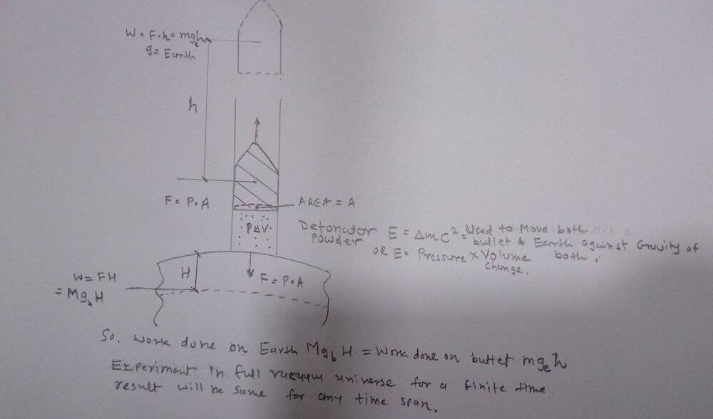

Kindly note that, Earth & object both has gravity influence on each other in attached sketch. both floating in full vacuum universe without influence of other forces/conditions.
Of course. In what way did you think @jbriggs444 and my responses didn't rely on that fact?

Please see attachment.
I wasn't arguing with anyone. I was just restating the basic problem that most (all?) of us experience when stepping up from basic pre- 'Newtonian - relativity'. It's so 'obvious' to people that the Earth or the wall don't move. 'Common Sense' (haha) takes us on from that intuitive feeling.
Likes jbriggs444 and Adesh
That is just restating your mistaken claim that both Earth and bullet move the same distance. That is not the case in the frame where they were initially at rest.
Likes sophiecentaur
The attachment is fine as long as you realize that H and h are very different. The Earth, in this context is 'immoveable' and H is as near zero as makes no difference.

It's only partially fine - it concludes that the work done on the two is equal, which is not the case. The forces on the two are equal, so the work done on one is ##Fh## and on the other ##FH## (with a few simplifying assumptions about ##F## not being time varying). But ##h## and ##H## are not equal, as you observe.
No. I am not claiming both covers same distance. All three parameters Mg(obj)H = mg(earth)h value at both side is different
Given that ##Mg_{obj}=mg_{earth}##, which follows directly from Newton's law of gravity, your third sentence appears to be a claim that ##h=H##. So which are you actually claiming? ##h=H## or ##h\neq H##? The latter would be correct, but would undermine your claim about equal energies - as I pointed out in post #12, to which your diagram was a response.

See attached sketch in #14, Force F = P x A is the same for both Earth and bullet, Now h=H applicable when both items mass is same, and Fxh = FxH. But here, Earth mass is too much So, Fxh ≠ FxH. See the attachment, At rest(against gravity) Mg(obj)xH = mg(earth)xh will be satisfied.
  • #32
This is just nonsense. Why don't you apply the conservation of momentum? This will actually get you to the right answer.
