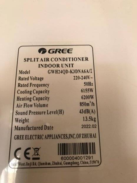

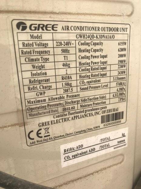

Hello,
I bought an air conditioner 24000 btu Inverter. ( for home). The indoor unit makes strange noises/sounds at night.
The pattern is as follows:
First, wind blowing and cooling are reduced to 80%. (Similar to fan mode)
After some minutes(About 3-4 minutes),
Then the sound (sound in the video) comes a few times and then everything returns to normal.
Wind blowing and cooling will be normal and will not be a problem.
No sound comes out of the outdoor unit.
Please watch the video.
thank you

Thank you,
Do you know if an additional condensate pump has been installed inside the indoor unit?
I don't know, but I attached AC technical specifications. (PDF file)
Do you have more than one indoor unit in the same system?
One indoor unit.
Your link is not the manual of the AC, but I do not have any errors on the LED display.
