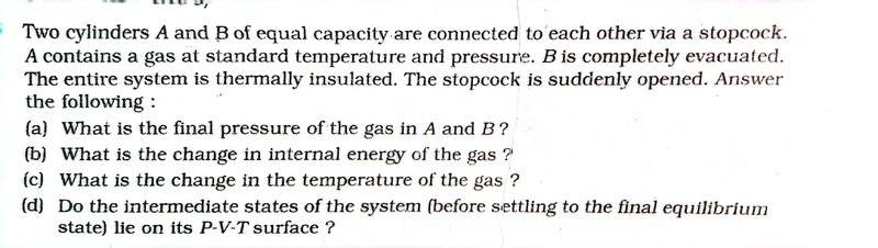

Why is temperature constant after gas has expanded?
In summary, the answer given for part (c) in the back is that temperature doesn't change as the gas in cylinder A expands to fill cylinder B.
vcsharp2003
897
177
The problem from the chapter on Thermodynamics is as given in the screenshot below. I am interested in part (c) of the question.
##PV=nRT## (Ideal Gas Law)
##Q = \Delta U + W## (First law of Thermodynamics)
The answer given for part (c) in the back is that temperature doesn't change as the gas in cylinder A expands to fill cylinder B.

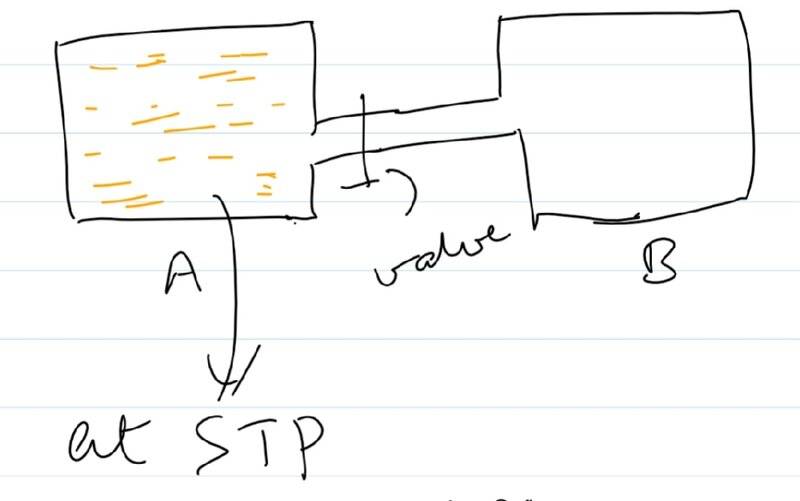

The thermodynamic system here is composed of the two cylinders A and B joined by some pipe.
But, I cannot find a satisfactory explanation for temperature remaining constant as the ideal gas expands to fill cylinder B.
I know the system is completely thermally insulated from its surroundings so no heat can flow in or out of the system, but that doesn't mean temperature of the ideal gas cannot change as it expands as for an ideal gas ## \dfrac {PV} {T} =~ constant## which means as V increases, so can T. Also, the process of expansion of gas is not given to be isothermal in the question. So, I am at a loss to explain that temperature is remaining constant in the process.

I see. But how can one conclude that ##P## and ##V## exactly compensate each other so that ##T## remains constant? May be ##P## and ##V## do not exactly compensate and their product ##PV## changes.
Because “the entire system is enterely insulated”.
Same amount of energy remains inside the system because heat transfer is zero.
In real life, there is no perfect insulation and what you properly describe happens.
But temperature can change in an adiabatic process of an ideal gas. Atleast, that's the idea I have and so this process being an adiabatic process can also have temperature change.
Only if the gas does work. Here the gas expands freely which means no work done. Since we have already established that no heat transfer takes place, the right hand side of the first law is zero which makes the change in internal energy also zero.
I see. That makes sense.
So for the thermodynamic system, we can say that ##Q = 0## and ##W = 0## (since the gas expansion is against vacuum or maybe because the the thermodynamic system doesn't expand i.e. cylinders A,B do not expand).
Thus, by Thermodynamics First Law we have ##0= \Delta U + 0 \implies \Delta U= 0##.
Since internal energy of an ideal gas depends only on it's temperature, so we can say the process occurs at constant temperature.

Suppose we say that the boundary of our system with its surroundings is comprised of the inner surfaces of the two rigid cylinders, and our system consists of the gas within the two cylinders. How much work W does the gas do on the inner surfaces of the two rigid cylinders?
This is a tricky problem. If there is heat exchange allowed between the two cylinders (say through the valve), then their answer that the temperature does not change is correct. But, if no heat exchange is allowed between the two cylinders, then the air remaining in the left cylinder will finally be colder than initially, and the gas transferred to the right cylinder will finally be hotter than initially. Any interest in analyzing this version of the problem?
Likes vcsharp2003
OK, I'll bite. With the valve open and both chambers having reached equilibrium conditions, why would the molecules in the initially empty chamber end up having a higher average kinetic energy?
Viscous heating in the stopcock valve and recompression of the gas in the cylinder initially containing vacuum.

I’m coming into the thread rather late, but a few thoughts...
For an ideal gas, under perfect adiabatic conditions, only purely elastic particle collisions (with the walls and with other particles) are possible.
[Edi: I should add that the walls need to be stationary because rebound from a moving wall will change a particle's kinetic energy.]
Therefore the total kinetic energy of the gas particles can’t change. And so the average kinetic energy per particle can’t change.
The temperature of an ideal gas depends only on the average kinetic energy per particle. Therefore the final (equilibrium) temperature must equal the initial temperature.
Particle speeds are determined by the Maxwell-Boltzmann distribution. Soon after the valve is opened, the first particles to reach the far end of B will be the fastest ones. This mean initially the gas at the far end of B is hottest (but low density and pressure).
There will be a time and position-dependant variation of temperature during the period from opening the valve to reaching equilibrium. There is also the possibility of some sort of longitudinal wave being produced to complicate matters!
