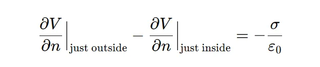

Why is the derivative assumed to be continuous?
dV_2/dn-dV_1/dn=sigma/epsilon
I don't understand how why the derivative is continuous. Clearly there is a surface charge and by gauss law we should have

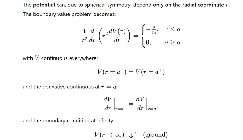

Where did the equations that you posted come from?
Are they supposed to be the solution to the problem you posted or some other problem?
I am particularly suspicious of this
What is ##\rho## in the region ##r\leq a## when there is vacuum in that region? Answer: Zero.
In any case, if the inner shell is held at potential ##V_0##, in the region ##r\leq a## the potential is also ##V_0##. The derivative "just inside" must be zero while equal to ##\dfrac{\sigma}{\epsilon_0}## "just outside." Thus the derivative is discontinuous across ##r=a##, the discontinuity being proportional to the surface charge density.
I see two possibilities
  1. The equations that you posted are correct but are meant to be solutions to some other problem.
  2. The equations that you posted are meant to be solutions for the problem that you posted in which case they are incorrect.
